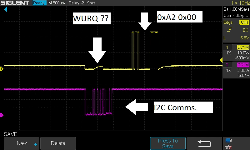

    Apr 26, 2021 08:01 UTC
    0693W00000AMU2QQAX.pngHi,
    it seems that I've been having problems while trying to generate the WURQ.
    In my case, it seem the WURQ has been partially generated and I don't know why.
    I attach an oscilloscope capture with two signals: YELLOW => C/Q and PINK => I2C DATA.
    In the capture you can see that I made a communication through I2C, then the WURQ seems to be partially generated, and then I write the command 0xA2 0x00
    DMato.1
    May 19, 2021 18:00 UTC
    Hi.
    You generate to long WURQ, but amplitude is O.K..
    Please, set up I2C bit rate to 400 kHz. Then WURQ will by 80 us approx..
    Second problem may by with configuration of UART. You must use EVEN parity. DATA + PARITY = 9 bites.
    Result for 0xA2, 0x00 you may seen bellow.

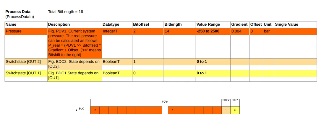

    I have a IFM PP7554 sensor. I want to get the pressure data and nothing else.
    I've triggered the WakeUp request and I can send commands like 0xA2 0x00 (MinCycleTime), 0xA7 03 (Vendor ID), and so on.
    The point is that I don't know how to get ProcessDataIn (the one in the picture)
    0693W00000GZ3fzQAD.pngCould anyone show an example of a byte sequence Tx and Rx to get these data?? I would be very pleased if so.
    Thanks in advance
