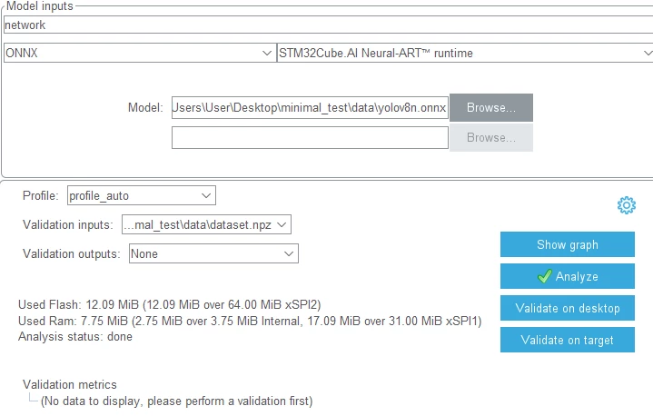

I've updated the model and generated a new dataset.npz file (included in model.zip). When I add this to CubeMX, I’m able to validate the model on my desktop successfully. However, I encountered an issue when trying to validate on the target device STM32N6570-DK board.
Here’s a screenshot of my current CubeMX configuration:
After pressing Generate Code and attempting to build the project, I get the following build errors:
../X-CUBE-AI/App/network.c:7652:41: error: 'inf' undeclared (first use in this function); did you mean 'jnf'?
 7652 | const float pad_const_value_native = -inf;
../X-CUBE-AI/App/network.c:7805:41: error: 'inf' undeclared (first use in this function); did you mean 'jnf'?
 7805 | const float pad_const_value_native = -inf;
../X-CUBE-AI/App/network.c:7958:41: error: 'inf' undeclared (first use in this function); did you mean 'jnf'?
 7958 | const float pad_const_value_native = -inf;
Any ideas on what might be causing this? Let me know if you need any additional details.
Thanks in advance!

The inf error is pretty strange, we are look for the cause, but it can be solved if you quantize the model.
The hardware acceleration on NPU is possible only with int8 layers, meaning that you need to quantize the model to use the n6 to its full potential.
You can quantize the model manually or via the dev cloud (upload the model, select the n6, quantize and download the output model).
https://stedgeai-dc.st.com/session
Then you can do the validation on target manually follow this:
https://stedgeai-dc.st.com/assets/embedded-docs/stneuralart_getting_started.html
(basically, use the st edge ai core CLI to do a generate, then the n6_loader.py then a validate command)
Or via X Cube AI that does the same automatically:
(Don't forget to change the baudrate)
I attached your model quantized with the dev cloud.
