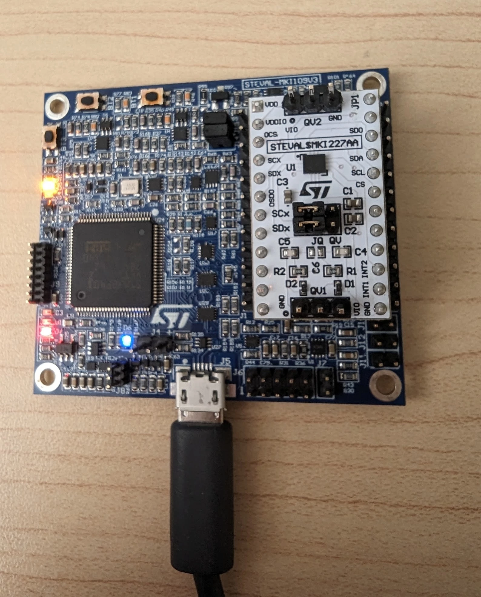

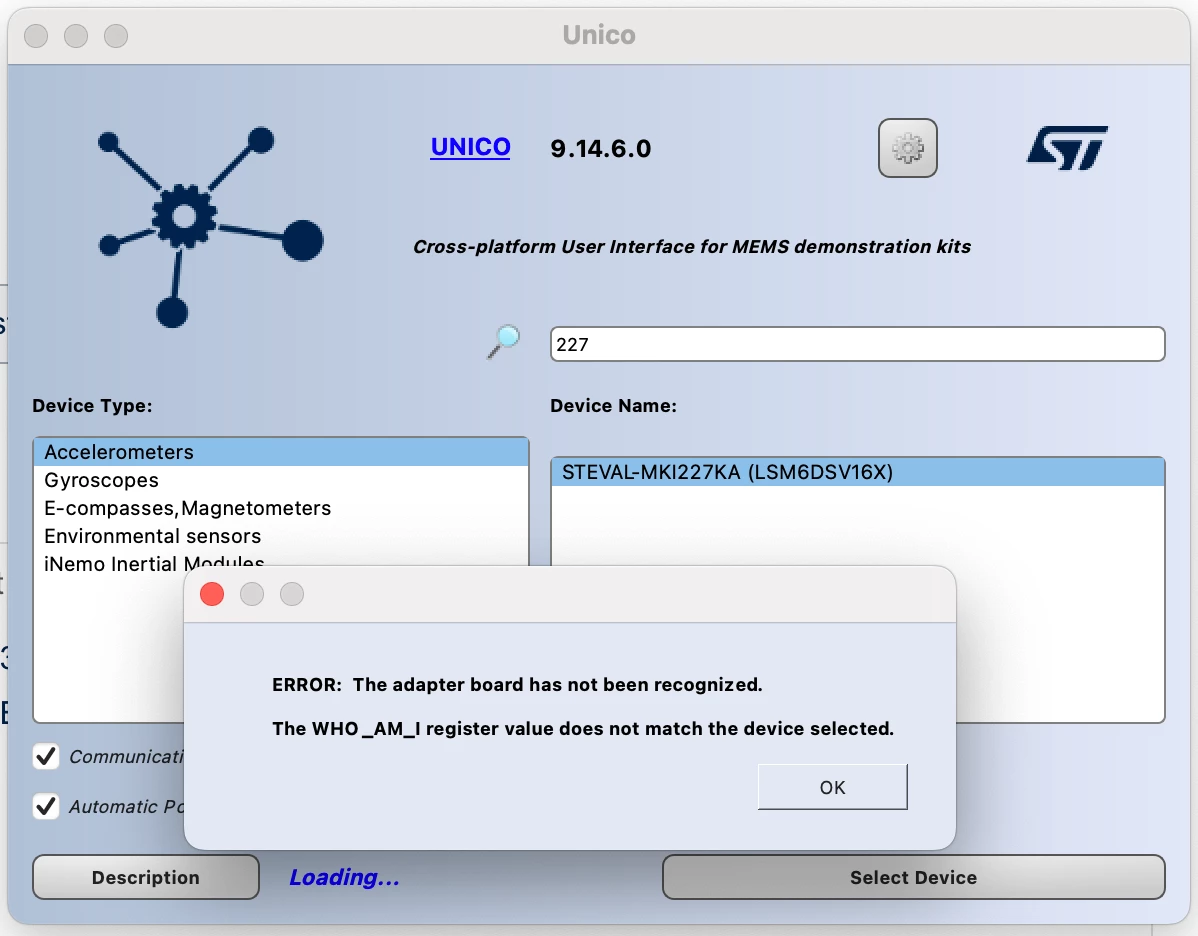

I am trying to use Unico 9.14.6.0 to get the evaluation module to work for the LSM6DSV16X.
But I am getting an error that says it's an unexpected device based on the WHO_AM_I register.
  • STEVAL-MKI109V3 updated to v3.48.3
  • STEVAL-MKI227KA (Labeled STEVAL-MKI227AA on board)
    I have switched the jumpers to the SDx SCx but that didn't seem to work either.
    Tried both mac and windows.
    Any help would be appreciated

also, can you share a picture of the setup?
Niccolò
July 11, 2023
Hi Niccolò,
I only have this adapter unfortunately.

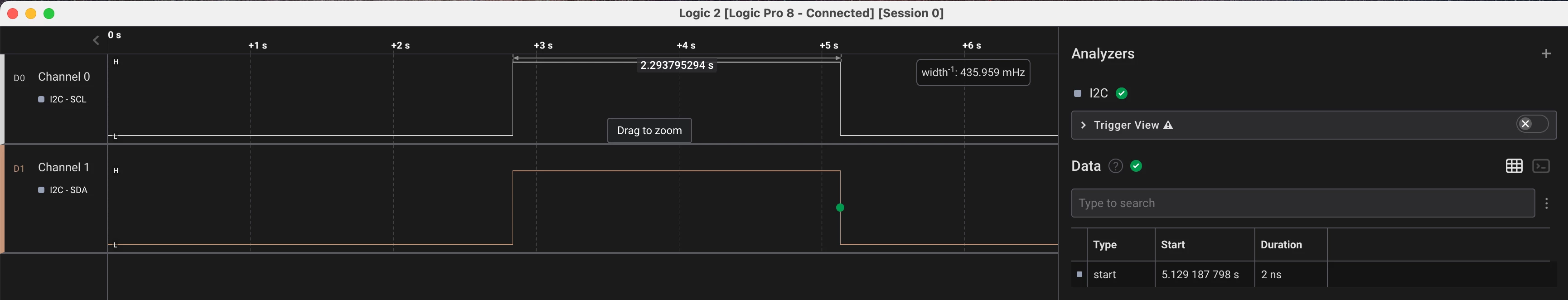

I probed the SCx and SDx lines and don't see any activity on this brand new dev kit. The lines just go high when you click connect, and low when you close the error.
Edit: Upon moving the jumpers back to QV, I see some activity, but still get the same WHO_AM_I error.
Attached is an image of both.

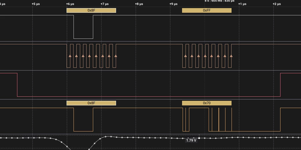

It looks like the chip is being wrongfully configured.
It tries to put it into 3-wire SPI, which appears successful, but doesn't read or write correct values, failing the WHO_AM_I register test.
If I hotplug the adapter board after this configuration, I can successfully see the response of 0x70 on the WHO_AM_I register on a logic analyzer, but the GUI sees this as 0xFF since it is expecting a 3-wire SPI response.

I have tried to use Unico 9.14.6 on both Windows and Mac with no success.
I just saw Unico version 9.15.0 was released for Windows, so I downloaded the ProfiMEMSToolV3.53.3_00_08000000.bin to the dev-kit through STM32CubeProgrammer in DFU mode, then tried to connect to the device on my windows machine. I still get Error WHO_AM_I register does not match on both computers.

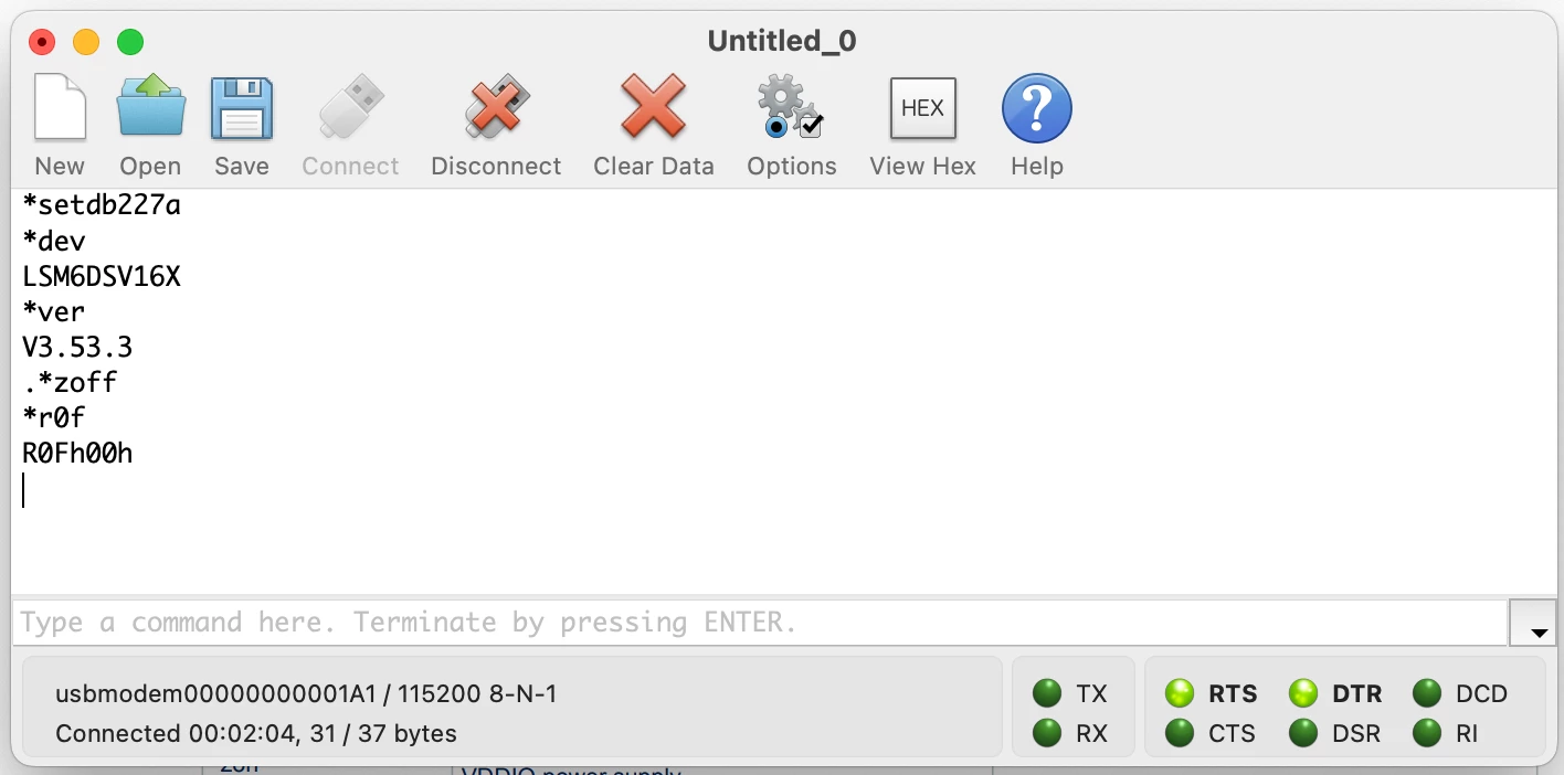

Trying to get to the bottom of this I have been issuing commands using a serial terminal.
The who_am_i register is not being read correctly. If you then hotplug the MEMS board, so it is no-longer in 3-wire SPI, it returns the correct 0x70 on regular SPI as shown on my logic analyzer image in a previous post above, but the GUI returns 00h still because it is anticipating 3-wire SPI.
If you could confirm the GUI works with the latest unico + binary, plus try these serial commands, it could help me figure out if there's a hardware issue.
