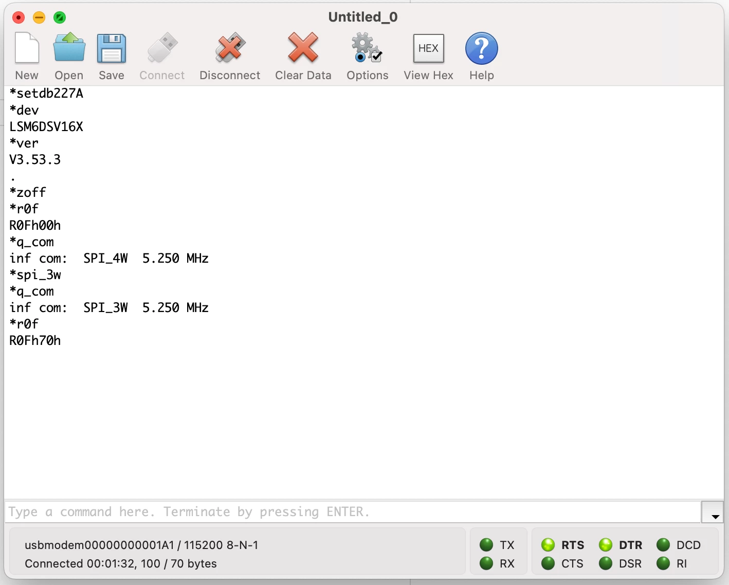

STEVAL-MKI227KA WHO_AM_I Register Value does not match
I am trying to use Unico 9.14.6.0 to get the evaluation module to work for the LSM6DSV16X.
But I am getting an error that says it's an unexpected device based on the WHO_AM_I register.
  • STEVAL-MKI109V3 updated to v3.48.3
  • STEVAL-MKI227KA (Labeled STEVAL-MKI227AA on board)
    I have switched the jumpers to the SDx SCx but that didn't seem to work either.
    Tried both mac and windows.
    Any help would be appreciated

Hi @JeffWelder ,
I confirm you that the device should work:
Can you check with q_com in which configuration you are?
July 26, 2023
Thank you for testing this! :)
Attached are my results.
If you can provide v3.53.1 I would be willing to try it, otherwise I think I have to return the board(s) as defective?

Hi @JeffWelder ,
I also tried with version 3.53.3, so that cannot be the issue, I'm sorry =\
anyway, I would like to check one last thing:
the SPI 4Wire read is the one at fault, and the SPI 3Wire is good, right? (from the previous messages, I understood the opposite =P)

Yes, I seemed to have been mistaken between my logic analyzer lines, 3W works, and 4W does not.
So, I bought another brand new dev-kit and eval board from Mouser instead of Digi-Key, and I have the same exact symptoms.
3W works, and 4W does not through our Terminal test.
This is the last component of our design to be validated, so we'd like to resolve this or we'll be forced to pick another IMU. Are there any other suggestions or would it be possible to hop on a call with an FAE?
Thanks,
Jeff

Hi @JeffWelder ,
could you check all the lines SDO,SDA,CLK,CS during a 4W SPI read of the WHO_AM_I register?
so that we can confirm that the communication is coming back on the right line.
