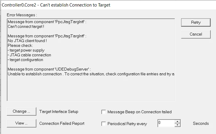

I'm currently working with a discovery board SPC58EC-DISP and I´m using a SPC5-UDESTK for debug, my issue is the next:
The first 2 - 3 days the UDE STK 5.2 works properly, I can connect to the board without problem,  but after those days I am not able to connect with the board, it shows the next message
I delete and installed again the UDE STK 5.2 and I was able to connect to the board again but after few days Im facing the same issue, I have two laptops and in both Im facing the same issue, also the power supply and all the configuration is the same when it connects to the board and when it doesn´t connects, I read in some forums that it could be a power supply issue but definitely this is not the case because nothing changes when it works and when not..

Regarding the issue:
The error message tell that nothing has been detected at JTAG.
Reason might be:
  • Power supply issue
  • Issue with target connection
  • Wrong software flashed (invalid clock settings, resets shortly after power on -> reset escalation )

eliozepedaAuthorBest answer
Sep 5, 2025 12:11 AM UTC
Hi Ethan,
I didn’t solve the issue, but I found that uninstalling and reinstalling the debugger driver temporarily fixes the problem.
The driver installation executable can be found under:
C:\Program Files\pls\UDE Starterkit 2021\Driver\JtagUsbDriver
