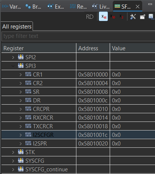

I have five identical development boards that I am attempting to bring up. One of the boards works without issues. The other four all fail during MX_LoRaWAN_Init(), After digging a little deeper I found that the SubGhzSPI peripheral is never getting enabled.
For non-working boards:
After calling MX_SUBGHZ_Init() all of SPI3/SubGhzSPI registers show 0x0 and I unable to change the values by writing to them.

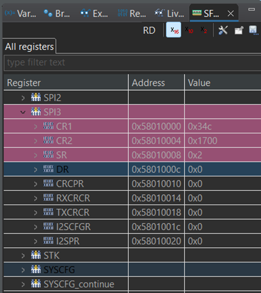

0693W00000Y7A7qQAF.pngAnd this is what I see with identical firmware on the working board after MX_SUBGHZ_Init():
0693W00000Y7A7vQAF.pngAll of the other peripherals seem to be working correctly (I2C, ADC, SPI) but I cannot configure or enabled the SubGhzSPI (SPI3). I noticed the SubGhz SPI is the only peripheral on APB3. Is there any way to reset, reconfigure or test APB3?

I was never able to recover any of the units that had this issue. I was able to trace the issue down to one of two things that I may have been doing incorrect. First, when I was programming these chips for the first time I was using Hot Plug instead of Under Reset. Second, the power supply I was using to power the board was very cheap and low quality. Since switching to a better power supply and not using Hot Plug I have not had another unit fail. I am not sure which of the two was causing the issue for me.

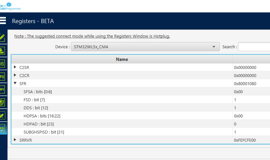

For other people finding this later, I've managed to resolve the issue on some boards by ensuring the SUBGHSPISD bit is SET in the option bytes to disable security on SPI3.
I've found what option bytes do on this chip (especially if self programming, e.g. for CPU2 vector table SBRV) very hit and miss as to whether something unintentional happens at the same time.
firmwareguru
Graduate
June 28, 2023
Thanks for the post, I would have not come across this solution otherwise.  I'm working with the stm32wle5 and have a board exhibiting this exact issue.  This option byte (bit?) SUBGHSPISD is not documented nor normally accessible when device is viewed as a wle5.  However I found a way using STM32CubeProgrammer and register access mode to view the device as a wl5x and the bit shows up in the FLASH SFR register.  Setting this bit to 1 will grant access to SPI3 and the LoRa radio works again.
