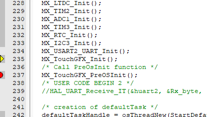

derek2399
May 16, 2023
I have a horrible feeling I have done a similar thing. I had a program working fine and after adding to it, it would not compile (even when I removed the changes), so I ended up copying files into a new program (with the later Cube V6.81 / TouchGFX V4.21.4. It now compiles but gets no further than MX_TouchGFX_Init();

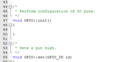

_legacyfs_online_stmicro_images_0693W00000bkC1GQAU.pngIt appears to finish at
_legacyfs_online_stmicro_images_0693W00000bkC2TQAU.pngin the TouchGFXGPIO.cpp program.
Most, if not all of this has been generated by Cube/Touch programs.

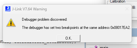

Incidentally, I don't know if it is related, but I also get this coming up consistently.
_legacyfs_online_stmicro_images_0693W00000bkC2JQAU.pngIs this likely to be related to updating Cube/Touch programs?
I foolishly thought working with the latest versions would be a good thing.

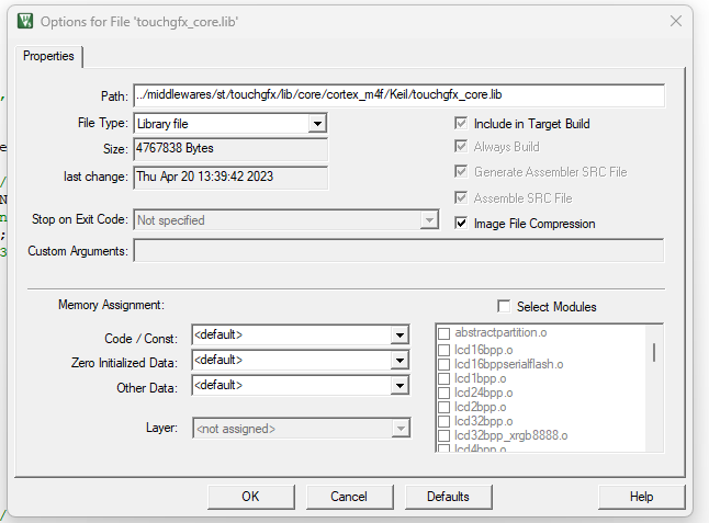

rgree.1
May 16, 2023
Derek, One issue I ran into during my upgrade was the project settings for the Linker had a Libraries search path that was picking up the wrong libtouchgfx-float-abi-hard.a file from the prior version of TouchGFX, make sure you are linking in the appropriate library.
derek2399
May 16, 2023
Thanks for taking the time to reply so quickly. It's much appreciated. I am using the Keil compiler and as far as I can tell, it appears to be use the same touchgfx_core.lib, which I think has the libtouchgfx-float-abi-hard.a within it ?? All the other project attempt's touchgfx_core.lib, have the same date 20-04-2023. I haven't seen any later versions, generated.
Please enlighten me if I am missing something or you feel something requires updating. I assumed it would just work and haven't much hair left to pull out.
