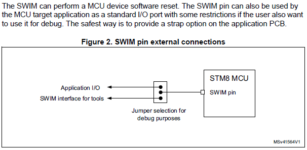

I am in trouble with the SWIM pin of STM8S.
According to the data sheet, unused pins should be set to OUTPUT.
However, I would like to keep SWIM pins in a state where they are normally unused and can be debugged only when necessary.
How can this be achieved?
Thank you for your advice.
�?Postscript】
I supplement my questions.
UM0470 has the following description.
Perhaps I think that I can switch between SWIM function and I / O function with a jumper, but I don't know the internal settings to achieve this.
In addition, when I / O is used, I want to apply unused-pin processing such as pull-up to the SWIM pin.
(In normal times, I / O is used to perform unused processing such as pull-up, and I want to be able to debug when there is an error.)
In summary, I have two questions.
・ How can I implement a specific method to switch between SWIM function and I / O as in the above example?
・ How to perform unused processing when SWIM is in I / O mode ?
Thank you.

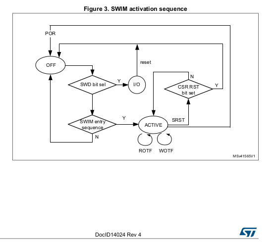

If you use the SWIM pin in your application, you will have to disable the SWIM interface from within the application. After it's disabled, only a MCU reset can re-enable the SWIM interface to do debugging (if you activate the SWIM interface before you disable it from within the aplication). So, it cannot do 2 functions at once.
And, if you don't use the SWIM pin, you don't have to set it as output, it has an active pull-up by default after reset.

Cristian Gyorgy
Senior III
If I remember well is was from experience, and then, searching for an explanation I found the activation sequence below. The one way arrows confirmed it for me.
Not sure if it applies to all SWIM revisions and devices.0693W000008GJxfQAG.png
