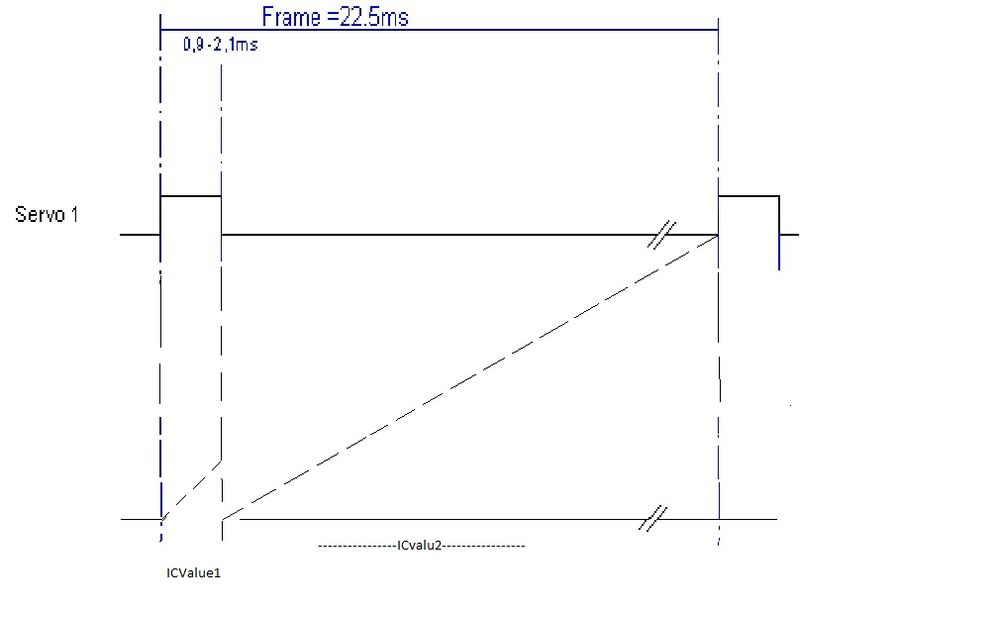

    Mar 18, 2010 6:14 PM UTC
    Posted on March 18, 2010 at 19:14
    My apologys I hadn't looked through the rm0016 document well enough to understand how the CC1 Flag worked, what I'm trying to say is that when CC1's Flag is active and it stores the value in ICValue1 it doesn't reset the counter on the next Flag activation. Basicly if CC1 flag is activated at say 15000 counts, that value is stored in ICValue1, but the counter is reset after the capture so that when the CC1 flag is activated a second time at 45000 counts from start, then that value gets placed into ICValue2, and the only time the counter gets reset is when it overflows.
    What I'm wanting to do is start the counter at either the falling edge or the rising edge (which ever I decide to set it to) and have the counter reset on the opposite edge.
    So for example of what I'd Like to do is, when a rising edge is detected the counter starts, then at the falling edge the counter stops then that value is placed in ICValue1 and the counter is restarted at the falling edge and is then stopped at the next rising edge, captured and saved to ICValue2, and the cycle is repeated again for the next pulse cycle.
    Also after looking threw the RM0016 document I found the PWM input example that does just that HOWEVER it only works for input on channel 1 or channel 2 on TIM1 but I need to use 4 channels, since the the signals coming from my RC-receiver are set up so that when CH1's pulse goes low CH2's pulse goes high, and when CH2's pulse goes low CH3's pulse goes high, and so on for 8 channels although I'm only gonna use 4 of them.
    Here an image of the servo pulses from the receiver.
    And here is how I wanna try and capture the signals.
    I apologize if the images are oversized.
    lowpowermcu
    Mar 19, 2010 7:50 AM UTC
    Posted on March 19, 2010 at 08:50
    Hi Mken C- learner,
    I have looked for in the reference manual if something could help you.
    PWM input couldn't help you because it counts the cycle report and total period but what you need in your application is measuring both high and low levels duration. Isn't it ?
    But I have a question: why you don't ICValue 2 - ICValaue1 and you have the duration you need ?
    If the solution above isn't suitable for you, I can suggest to look for in the reference manual how to use the trigger selection ''TS'' bits in SMCR register it could help you because there description on how to reset the counter on external event.
    Keep me informed if you have updates / questions ?
    Mit besten grüssen,
    MCU fan
    kmorri2004
    Mar 19, 2010 9:01 AM UTC
    Posted on March 19, 2010 at 10:01
    Thanks lowpowermcu for the help, using ICValue2 - ICValue1 only works to a degree since the counter doesn't reset until overflow which causes random numbers in both variables.
    However I did manage to get it 90% figured out, I have it now where the mcu can replicate and match 2.5 of the 4 inputs, channels 3 and 4 work perfectly but channel 2 is changing with ch1 commands and ch1 simply is being captured correctly, instead ch1 is counting the entire period from high pulse to high pulse....
    EUREKA!!
     I just figured out how to do it, here's a copy of the code there are a few variables that aren't needed I'm just using them to try and figure out how to duplicate the inputs cycle time to clean up and stabilize the outputs. Also some of the comments are incorrect due to my copy and pasting them from the example code and not modifying them.

    kmorri2004
    Mar 20, 2010 5:17 AM UTC
    Posted on March 20, 2010 at 06:17
    I can't find it at the moment but I remember reading that 5uS is equivalent to 1 degree on the servo, I'll be  running Brushless motors but they still use the same exact pulses as a rc servo. The minimum ontime is 1mS neutral is 1.5mS and Maximum is 2ms, I want it as precise as possible. As for the clock I have the Timers running at default 2MHz, the code could very well be simplified down to possible 6-10lines if the PWMIConfig command didn't ONLY work for TIM1 CH1 or TIM1 CH2 since it uses the complementary channel but the trigger is only available for TI1F_ED, TI1FP1, and TI2FP2, also the fact that this is the only way I've actually gotten the code to work with all 4 channels at once, although so far it ONLY produces a good pulse on the oscilliscope, tryed it on some servos and the servos all swing to max limit one way and don't respond to any command signals even with the controls set to neutral position.
    lowpowermcu
    Mar 20, 2010 8:16 AM UTC
    Posted on March 20, 2010 at 09:16
    Hi Mken,
    I have an other question is there a synchronization between the four signals or they are independent ?
    Is the pwm frame constant as you have drawn in the figure above: 22.5ms. If it the case why you need the off-time, you need the on-time and you can sustract the frame duration from the on-time to compute the off-time ????
    I am trying to understand more your application so I can suggest you the better config for timer.
    Mit besten grüssen,
    MCU Lüfter
    kmorri2004
    Mar 20, 2010 11:57 PM UTC
    Posted on March 21, 2010 at 00:57
    I'm not sure what you mean by synchronization of the signals.
    As for id the pwm frame is constant yes and no, yes its constant but its closer to 20ms exactly, and no because it does shift slightly but only by 1ms.
    I wanted the off-time originaly because that was the only was I was able to get the 1ms-2ms on-time output, not realizing that pwm mode 2 on the outputs is a beter choice for this and I have since switch the outputs from pwm1 mode to pwm2 which is working much beter, since I can just send the cptured value directly to the output with a few exceptions in ch3 and 4 since the capture after ch2 so their values are the sum of the previous channels and that channel combined so there is a little math involved but not much.
    I have also fixed most of my servo signal outputs except for CH1 it works now but incorrectly, instead of stay at say the neutral servo position it oscillates but I pinpointed it down to me using TI1F_ED to reset the counter at the start of the pulse sequence, and still be able to get a usable capture value for CH1.
    Here's a revised version with all the updates.

        CH1on = TIM1_GetCapture1();
        TIM1_ClearFlag(TIM1_FLAG_CC1);
        while((TIM1->SR1 & TIM1_FLAG_CC2) != TIM1_FLAG_CC2);
      /* Get CCR1 value*/
        CH2on = TIM1_GetCapture2();
        TIM1_ClearFlag(TIM1_FLAG_CC2);
        while((TIM1->SR1 & TIM1_FLAG_CC3) != TIM1_FLAG_CC3);
      /* Get CCR1 value*/
        CH3on = TIM1_GetCapture3();
        TIM1_ClearFlag(TIM1_FLAG_CC3);
        while((TIM1->SR1 & TIM1_FLAG_CC4) != TIM1_FLAG_CC4);
      /* Get CCR1 value*/
        CH4on = TIM1_GetCapture4();
        TIM1_ClearFlag(TIM1_FLAG_CC4);
        periodcountX = (CH2on + CH2ontime);
        periodcounty = (CH3on + CH3ontime);
        periodcountz = (CH4on + CH4ontime);
        CH3ontime = (CH3on - CH2on);
        CH4ontime = (CH4on - CH3on);
        /*TIM1_PWMIConfig(TIM1_CHANNEL_2,TIM1_ICPOLARITY_RISING, TIM1_ICSELECTION_DIRECTTI, TIM1_ICPSC_DIV1,0);*/
        TIM2_TimeBaseInit(TIM2_PRESCALER_1, periodcount);
        // Initialise output channel 2 of TIM3.
      TIM2_OC3Init(TIM2_OCMODE_PWM1, TIM2_OUTPUTSTATE_ENABLE, CH1on, TIM2_OCPOLARITY_LOW);
      TIM2_OC1Init(TIM2_OCMODE_PWM2, TIM2_OUTPUTSTATE_ENABLE, CH2on, TIM2_OCPOLARITY_LOW);
      // Enable TIM3.
      TIM2_Cmd(ENABLE);
        TIM3_TimeBaseInit(TIM3_PRESCALER_1, periodcount);
      TIM3_OC1Init(TIM3_OCMODE_PWM2, TIM3_OUTPUTSTATE_ENABLE, CH3ontime, TIM3_OCPOLARITY_LOW);
      TIM3_OC2Init(TIM3_OCMODE_PWM2, TIM3_OUTPUTSTATE_ENABLE, CH4ontime, TIM3_OCPOLARITY_LOW);
      // Enable TIM3.
      TIM3_Cmd(ENABLE);
