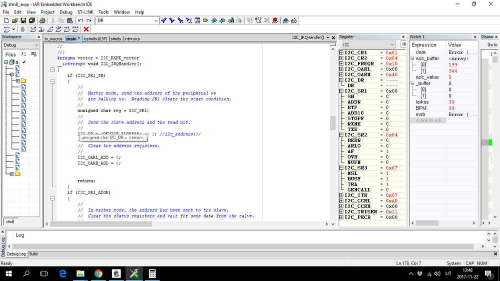

First, somehow DR (data register is not showing anything), I clean ADDR by reading SR1 and SR3, clean TXE by writing DR twice, but can't get any data to buffer from MXL90614 temperature sensor

Well, the code *may be* correct - though it does not use the official STM library for i2c and system clock.

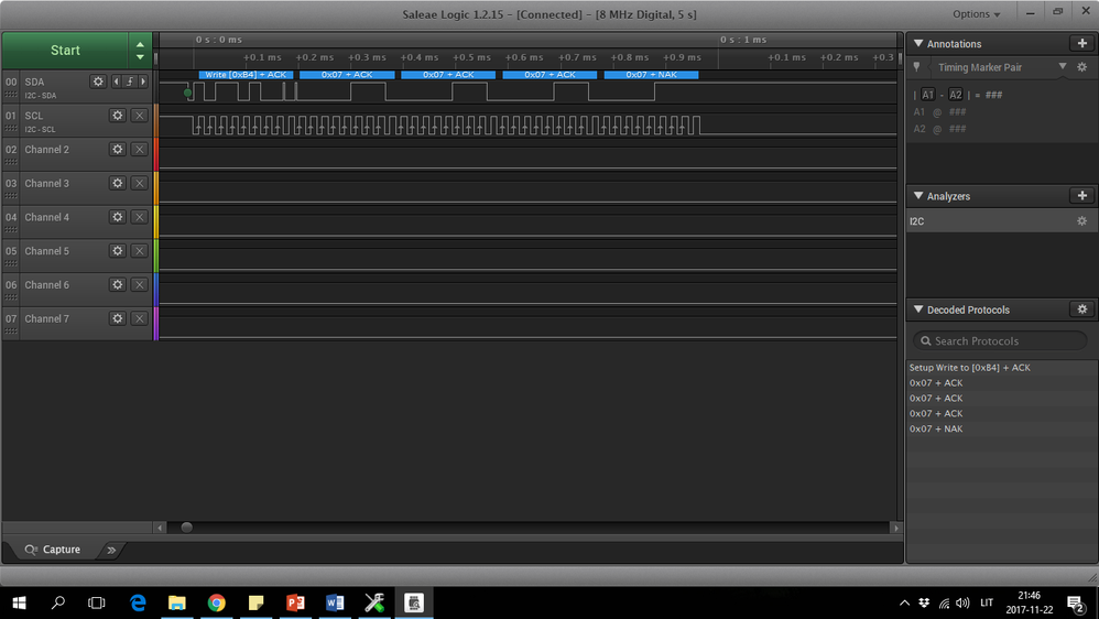

You need to hook a logic analyzer on i2c lines and see what the host sends and what the sensor answers.

Sure.
It send this. Though according to manual I send DR 2times to clear txe. Address of device 0x5A
Posted on November 22, 2017 at 21:56
This is a write command because the lowest bit of the address byte (0xB4) is 0. To read, set the lowest bit to 1 (0xB5).
-- pa
