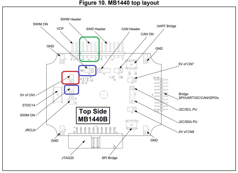

I have a STM8S103F3P6 STM8 ARM Minimum System Development Board and st link v3. How can i get power to the swim connector and what voltage is it. Thank you

The SWIM connector takes a voltage as an INPUT (1.65 V to 5.5 V)
If you need 5V pull it from the jumper location

ok used the usb port to power the board and got it to program with STVP

Also, how come the st link v2 supplies target voltage and v3 takes an input? I can program this board with an ST Link v2 without any other connections but the St's usb port. Why does the programmer take vcc? Sorry, very new to ST MCU's only have experience with this stm8s and the blue pill.

Every MCU works in a range of VCCs not just a single VCC. stlink measures the target VCC and sets some IO parameters. Also you can check the VCC on your PC using stlink.
