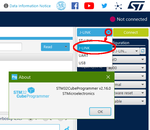

There should be the option J-LINK behind the turquoise drop down button, per default showing ST-LINK:

i just downloaded CubeProgrammer , newest version , 2.16.0.
and can select J-Link now :

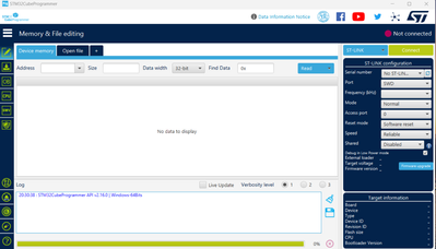

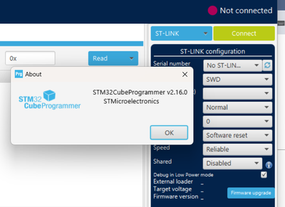

Thank you very much for your immediate reply. I have version 2.16.0. But there is no J-link supported in it. Drop down manue does not show  j-link.

J-LINK is supported since CubeProgrammer 2.16.0 and CubeMonitor 1.8.0.
Does it answer your question?

I just downloaded the new version. But it did not help as well. There is no option to select J-link. I have windows 11 Home edition installed. Can you please look into this. I had old version installed and i also updated directly from the old version that also did not help. I think something is wrong with installation file.

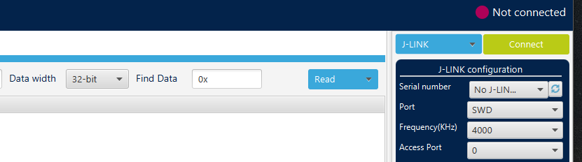

Thank you very much there it is. I missed that option.
