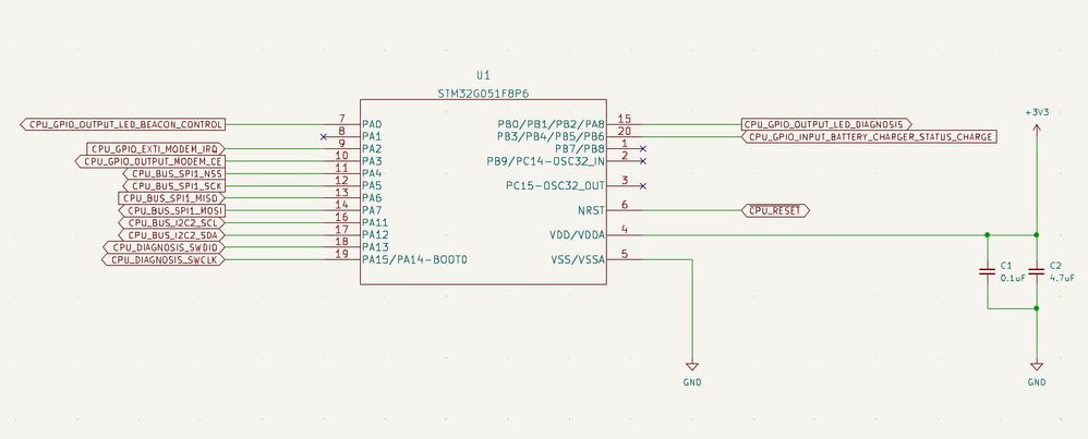

I'm using the TSSOP-20 package STM32G051.
After attempting to write some optional bytes, the situation is completely ruined. no longer able connect debugger, Erasing flash, and changing optional bytes.
1. My custom board is configured as follows and worked well without any problems before.
2. Working with STM32CubeProgrammer 2.16.0 and ST-LINK V3, and SWD connection.
2-1. Cannot connect with "Normal", "Under reset", "Power down" Mode. will output the following message and fail:

3. On the RESET pin, 0V is measured. After connecting the external strong pull-up resistor and forcing it pull up and I tried the above process again. but still not working. (returned DEV_TARGET_HELD_UNDER_RESET)
4. I tried using with old 'STM32 ST-Link Tool'. A connection attempt is possible, but the program stops working (main window is not responding. (ST-Link V3's activity LED blinks red/green quickly too.)
It seems that the option byte is contaminated and the wrong function is running. (like Hardware IWDG option, etc.)
but Unfortunately, in the TSSOP-20 package, the BOOT0 pin is already in used by SWD.
Is there anything else I can try? thank you in advance for your support.

"... attempting to write some optional bytes." is rather vague. Apparently some PCROP and WRP area settings had been touched. Probably the only way back is reset WRP areas to default (see "ST production value" in RM), set PCROP_RDP bit and do a RDP regression (i.e. increase RDP level to 1, then decrease to 0) and *AT THE SAME TIME* revert PCROP area settings to defaults (again "ST production value").
Thank you for your answer.
I agree with this, I was able to read FLASH register using the STM32CubeProgrammer. the FLASH_OPTR data reports 0x00000000. I think the enabled hardware watchdog is triggering a unwanted reset and RDP is set in level 2 (Read protection) mode. my chip is refusing almost any actions including download new firmware, MASS ERASE and CHANGE RDP/PCROP.
