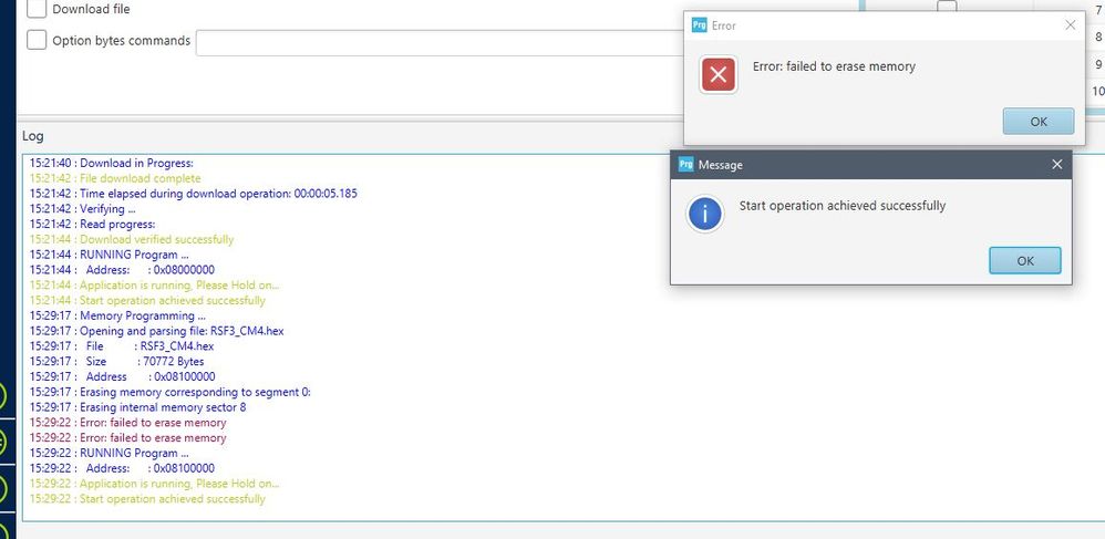

STM32CubeProgrammer v2.7.0 Erase error
Hans T
Senior

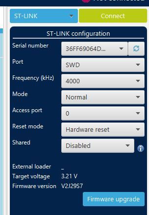

Since I am using the version v2.7.0, I get this error after programming both cores after the first time:
I can fix this by Disconnecting the STM32H7, and Connected again
1 REPLY 1
Houda GHABRI
Hi @Hans T​
According to your debug traces your M7 application seems to be doing something perturbing Flashloader operations.
Let me explain what you are doing exactly :
  • You are programming Bank 1 and Launching the programmed application by M7.
  • Then you program another application (seems to be your M4 appli) in Bank2 and you launch the progammed application by M7 too (not M4) , am I correct?
What I recommend :
  • Program the M4 application (in bank2) (without launching it).
  • Program the M7 application (in bank1) and launch it.
Hope it helps.
