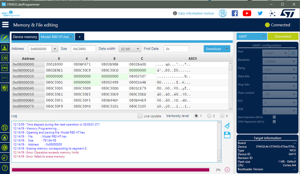

The latest STM32CubeProgrammer (V 2.15.0) appears to be unable to program an STM32L471 microcontroller.
It communicates successfully but fails with error:
    Error: Operation exceeds memory limits
    Error: failed to erase memory
The hex file memory size is 781.64 KB, the micro's flash size is 1 MB.
This file programs without issue with an older version of STM32CubeProgrammer (v 2.4.0).

Hello @Chris21,
Issue confirmed and transferred to CubeProgrammer development team.
Internal ticket number:  172951 (PS: This is an internal tracking number and is not accessible or usable by customers).
For now, a workaround with CubeProgrammer v2.15 would be to replace the attached file in "$CubeProgrammer_installation_path/Data_Base" directory.
Let me know if this resolves the issue.

Hello @Aziz BRIGUI,
The file provided does resolve the issue.
Thank you for your support.
