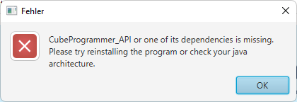

I have the following problem. I recently installed Windows 11 and tried to install the STM32CubeProgrammer. But non of the following versions work with Windows 11
STM32CubeProgrammer 2.11.0
STM32CubeProgrammer 2.10.0
STM32CubeProgrammer 2.9.0
I always get the same error:
I use Java Version 1.8.0_341. Would be nice, if someone knows an answer! :)

Hi @TWolf.2​ ,
Can you please tell me step by step how do you install CubeProgrammer?
Do you install it with administrator rights?
FYI no need to have java installed in your PC , STM32CubeProgrammer runs with a bundled JRE.

I tried to install with admin rights and it is working.
Thanks for your help!
