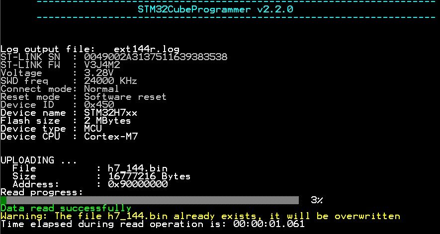

CLI application stops reading 16MB QSPI after reading less than 1MB (one buffer to RAM), percent progress bar doesn't advance.
STM32_Programmer_CLI --connect port=swd --vb 3 --log ext144r.log --extload CLIVEONE-W25Q128B_STM32H7xx-NUCLEO-144.stldr --upload 0x90000000 0x1000000 h7_144.bin

UPLOADING ...
20:14:33:212 File : h7_144.bin
20:14:33:214 Size : 16777216 Bytes
20:14:33:228 Address: : 0x90000000
20:14:33:234 Read progress:
20:14:33:235 Reading data...

20:14:34:389 r ap 0 @0x90000000 0x0007E000 bytes
20:14:34:390
Data read successfully
20:14:35:070 Warning: The file h7_144.bin already exists, it will be overwritten
20:14:35:094 Time elapsed during read operation is: 00:00:01.156

​Hi Clive,
The first issue of your ticket that was reading failed from Flash QSPi External, this problem is fixed in version 2.2.0.
But there is now another problem: read more than 1 MB (only available with CLI) is still not possible, I confirm.
The Cubeprogrammer development team is aware of this problem and will be corrected shortly.
