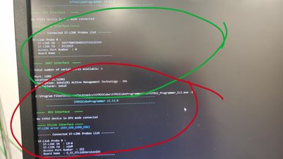

When running stm32_programmer_cli.exe -l
the first run shows a valid SN and FW version.
The 2nd and subsequent runs show corrupt SN and FW version.
The STM programmer version is 2.13.
This repeats on 2 new ST Link debuggers.
This repeats on 2 different computers.
Please see image

kfruchtnis
problem repeats with latest 2.16
C:\Program Files\STMicroelectronics\STM32Cube\STM32CubeProgrammer\bin>STM32_Programmer_CLI.exe -l
STM32CubeProgrammer v2.16.0
===== DFU Interface =====
No STM32 device in DFU mode connected
===== J-Link Interface =====
Error: No J-link probe detected.
===== STLink Interface =====
-------- Connected ST-LINK Probes List --------
ST-Link Probe 0 :
ST-LINK SN : 34FF70063048553715232343
ST-LINK FW : V2J29S7
Access Port Number : 0
Board Name :
===== UART Interface =====
Total number of serial ports available: 1
ST-LINK error (DEV_USB_COMM_ERR)
Port: COM3
Location: \\.\COM3
Description: Intel(R) Active Management Technology - SOL
Manufacturer: Intel
ST-Link Probe 0 :
ST-LINK SN : ����
ST-LINK FW :
Access Port Number : 5570652
Board Name : �@
Port: COM3
Location: \\.\COM3
Manufacturer: Intel
