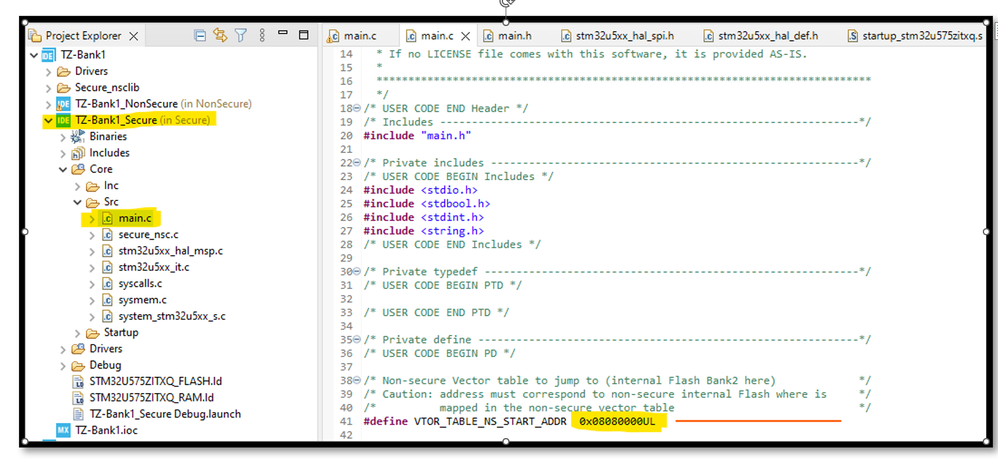

Can someone help me where I am doing something wrong so that these errors are appearing? Is it that I did not set some parameters on "Option bytes" (by using STM32CubeProgrammer. See the attachment for details) or something else I need to check? By the way, I did not able to find "RDP level" in "Option bytes" feature.

_legacyfs_online_stmicro_images_0693W00000bl7YvQAI.pngas per your configuration it look like your both bank is configured as secure. Kindly update
SECWM2_START value = 0x01
SECWM2_END value = 0x00
apply and save and try to debug.
SECWM2_START value > SECWM2_END value required to configure bank2 as non-secure.
_legacyfs_online_stmicro_images_0693W00000bl7aSQAQ.pngCheck your jump address in secure firmware. it should be start of your bank2 address

Hi @GTest.1​
As you enable trust zone, your project should be divided into to parts
  1. secure or NSC firmware
  2. Non-secure firmware
First secure code will be executed and then it will jump to non-secure firmware.
I thing if you have used sample code then one bank is used for secure firmware and another bank is for non-secure. So check
Hard fault occurred due to improper memory allocation of secure and non secure. It also occurred many other reasons.

@vijay_03​ Thanks a lot for your elaborate clarification. Really appreciate that! I have changed the values as you suggested and it works perfectly. Again thanks a lot!
