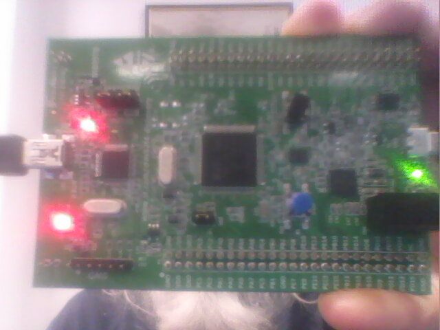

Hello @SElli.11,
The fact that your board is wrongly recognized is pretty odd. Could you photograph it? also the marking on the STM32 Chip?
Also, have you modified the CubeProgrammer installation in any way?
Aziz
Hi @Aziz BRIGUI,
Thank you for your reply. As requested, the photograph.
STM32F407 Discovery BoardSTM32F407 Discovery Board
The marking on the chip is :-
STM32F407
VGT6
STM32CubeProgrammer v 2.19.0 has not(!) been modified in any way. I hope this is of use.
Stuart
Please post a good, clear, in-focus photo!
As @Aziz BRIGUI said, the markings on the chip need to be clear.
With respect and apologies, this is as clear as I can get the markings on the chip.
Stuart

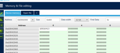

Hello @SElli.11,
That's OK we understand, could you read @0xE0042000 and send me a screenshot like this one ?
Aziz
