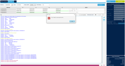

Hi, I am a beginner in STM32L4. I set DBANK unchecked accidentally in STM32CubeProgrammer on STM32L4S7ZIT6. Now I want DBANK to be checked, but I don't know how to do.
I try check DBANK and apply, but fall. It give me 2 errors. (after read, the DBANK still unchecked)
Some other reference:
I try to use Full chip erase, it success. But show the address I haven't see before.
when I download SBSFU in this board, it fall.
I want DBANK to be checked and become normal (when DBANK is checked, I can download SBSFU).

Could you please make sure you are using latest version of CubeProgrammer? Could you check the FlashLoader being used?
