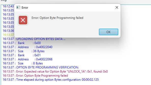

Hello lovely people,
I seem to have run into a headscratcher that I can't get out of.
I have a NUCELO-U575ZI-Q that I've carried out the following steps on:
  1. Connect board to PC
  2. Connect with STM32CubeProgrammer Normal Mode, 24000KHz, SWD
  3. Uncheck UNLOCK_1A in the Option Bytes Screen.
  4. Disconnect and reconnect within STM32Cube
  5. Attempt to Check UNLOCK_1A to reverse the protection
  6. Encounter the following error:
I've also tried using the CLI and can't get any different results, am I missing a step to be able to reprogram the option bytes?
Thanks in advance for your help!
1 REPLY 1
ANiki.7
Possible solution:
If I raise the RDP level to DC. Then disconnect/reconnect. Then select AA on RDP, and CHECK UNLOCK_1A - the option bytes successfully program.
For some reason, both things have to happen at the same time (RDP regression, and the UNLOCK_1A byte being programmed)
