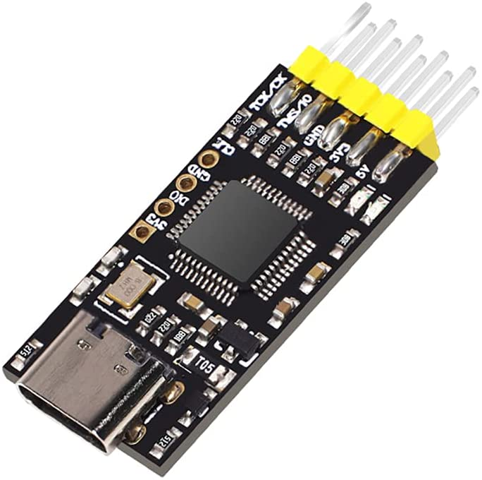

Re-worked/Re-factored a lot of the H7 Keil FLM loaders last weekend to unify the code and improve support.
Primarily Winbond and Micron parts on the H7xx, H7Ax (QUAD and OCTO) boards.
Also testing the .FLM on the CMSIS-DAP as a practical alternative to ST-LINK's
