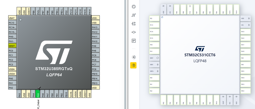

Just as a comparison for readability. Here are two chips side by side on the same monitor. The STM32CubeMX text is large and legible. The STM32CubeMX2 text is TINY. Probably half-size. And this is true even though the left chip has more pins!
Also, as @Niclas Hedhman mentions, the bizarre white on slightly darker white color scheme is apparent. There appear to be 4 different shades of white to light gray in the image. The left one looks like a chip. The right one looks like the beginning stages of a UI project. In particular the "shadow" effect behind the chip makes it looks like a powerpoint slide more than a usable tool. I don't need lightning bolt symbols, I need readable text.

Another comparison:
In STM32CubeMX, it takes 2 mouse clicks to assign a pin as a GPIO output. Click the pin, click "GPIO_Output". Done. The clicks are even right next to each other. And you can see the pin is an output, as well as additional configurations when you hover over it. Easy.

In STM32CubeMX2, to assign a pin as an output:
  • Click the pin.
  • On the right side of the screen, click "GPIO"
  • Click the Gear button next to GPIO to see options. This changes the view from Pinout to GPIO.
  • In the middle of the screen, first find the pin you were working on, then click "Mode" and then select "Output".
  • Click "Pinout" to return to the pinout view.
6 clicks!! And it shows you all pins so you have to remember which one you want to change. And even after all of that, there is no way to see at a glance on the pinout view that the GPIO is an output. How is a tooltip that explains that you can drag and drop signals more important than whether the pin is an input or an output?
Assigning pins as input and output has to be among the most common scenarios ever. Yet the new STM32CubeMX2 is comparatively awful at doing it and presenting that information.
