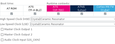

Tried all different settings with Cube MX: Crystal, Disabled, Bypass but nothing works to fix the panic after Cubeprogrammer transferred partition 0x03 Fip-boot and then shows a "reset". the usb connection is lost and cubeMx dumps a bunch of warning dialog boxes.
https://community.st.com/t5/boards-and-hardware-tools-mpus/cannot-boot-up-custom-board-which-based-on-stm32mp157c-dk2-only/td-p/280969
This board uses also a crystal, but the link mention on many replies from st:  https://wiki.st.com/stm32mpu/wiki/Clock_device_tree_configuration_-_Bootloader_specific   is broken. Reported this several times but no one is helping ?
CubeMX is set correctly for crystal:

Is this right ? How the select bypass so that it generates:
&clk_hse {
st,digbypass;
debugging

The key issues was to configure the clock settings and only 2 vdd nodes in the DT of TF-A.
See also the training material in the workshop.
