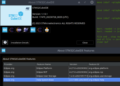

AScha.3
September 20, 2023
no need to update, because this editor hang-up still there...
i have ide 1.13.1 (with cube  6.9.1-RC1) installed on Linux MX18, some days ago.
Problem is in text boxes, to make some input, ie giving user defined name to a pin.
i had named a pin with LED on it : led-red . ok, but then i decided to write it more nice: to LED-red ->
open the dialog box on pin, click mouse -> cursor to "-" position, then backspace to delete the "red" .
error.box pops up : >> names must begin with a character or number << (or similar) -> OK.
but from now on cannot edit anything useful any more ! even close and open MX view : problem remains!
only close and restart full IDE makes edit possible again.
Always some fun with STM /or java (?) software . :)

Yup, and I have  feeling it's related to backspace. It happens often when trying to correct the entry in text boxes. Interesting no one reported this and I experienced this freeze for many years ! Not sure, but I believe CubeIDE is based on Eclipse., perhaps related to the core eclipse code.

--- dont believe ...just look:
+ edit box:
and problem may be : destroy start of string , using backspace.
this eclipse/java sh.t can make some surprise:
- on my laptop with Win10 , IDE 1.13.1 open never again, after creating a project. only >> error occured. see log. <<
surprise...
and here, on my Linux PC, had to install IDE new, after i made a big mistake: i install additional color scheme in eclipse, from eclipse marketplace. then i got new colors for Java - BUT cannot edit C-files anymore. IDE destroyed.
big surprise....
