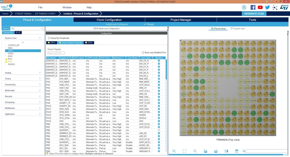

Alex R
April 22, 2019
Please try again with a new project, but do not choose the default values to initialized the peripherals.
See the attached picture below. It is possible to enable the LWIP Middleware without any conflict.
DOsbo
April 23, 2019
Hi Alex, thanks for your reply. I should have been more precise. I'm using the Evaluation Board STM32F769I-EVAL. I can see the discovery board does work like you said. However the STM32F769I-EVAL board starts out like this:
I think it has something to do with the FMC address/data lines taking up too many pins. I might have more luck if I start with just the micro (not board) and build the configuration up myself instead of taking things away from the board configuration.
