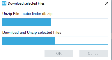

trying to create a New CubeMX project...... downloading forever
2022-12-22 6:12 AM

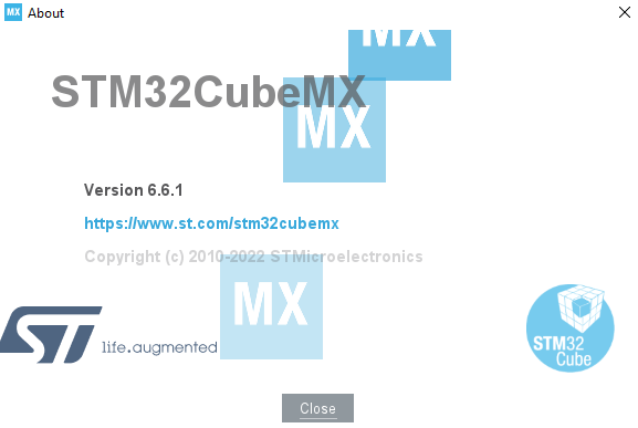

Is not a new installation of CubeMX v6.6.1, it has been working so far, untill today i try to File>New project.... and stays here forever
trying to unzip "cube-finder-db.zip"

located in
C:\Users\myuser\.stmcufinder\plugins\mcufinder\mcu\cs
didnt work
2022-12-22 6:27 AM
Trying opening CubeMX with admin right , didnt work
