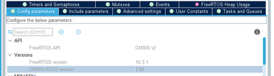

Hi all!
Where do I find the "true" version number for the CMSIS-RTOS code "injected" by CubeMX?
While STM32CubeMX (v6.9.1) shows "2.0.0"...
.. the header file in my project (CMSIS_RTOS_V2/cmsis_os.h) has the following in the comment header
* $Date: 10. January 2017
* $Revision: V2.1.0
* Project: CMSIS-RTOS API
* Title: cmsis_os.h FreeRTOS header file
followed by a version history, clearly mentioning Version 2.1.0.
Is the cmsis_os.h header file the "proper source of truth"? Or is it a different file?

Hello @mwb
The two pieces of information are not necessarily contradictory, the CMSIS-RTOS version in CubeMX refers to CMSIS-V2 and not CMSIS-V1,  it's not "2.0.0", it's just the V2
You can refer to the exact version with your CMSIS_RTOS_V2/cmsis_os.h file.
