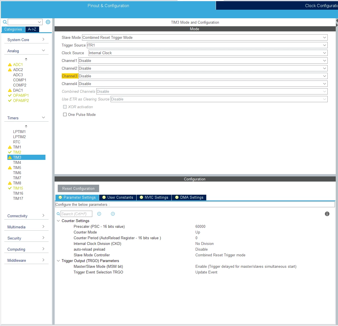

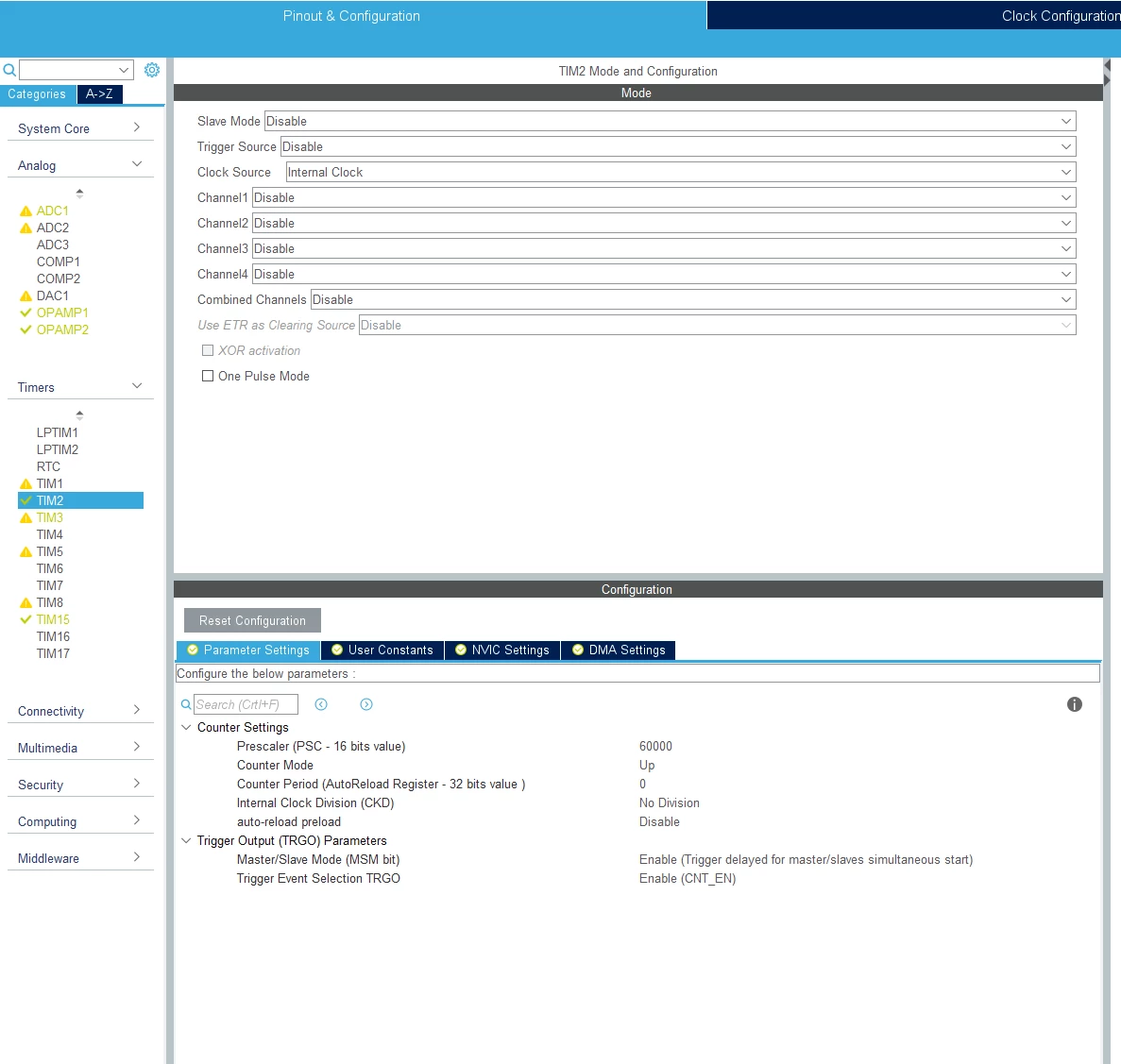

Hello everybody,
I think I have stumbled accross a configuration and initialization error when using STM32CubeIDE and the CubeMX peripheral initialization:
I am using a NUCLEO-L476RG board and want to use TIM2 to trigger TIM3 as a slave and start both timers simultaniously. As for TIM2 I use the following settings:
for TIM3 the following:
I also have acitvated the global interrupt on both timers since I want to use TIM3 to trigger the ADC and convert samples as long as TIM3 runs. TIM2 is the period at which I will send the avareged ADC samples to an external host.
So I normaly thouight that the code generator would uses the
HAL_TIM_SlaveConfigSynchro_IT(&htim3, &sSlaveConfig)
function. But instead I get the following initialization which I then manually change in the interrupt driven slave configuration function:

OK. I have found the problem.
The UIE Bit for update interval interrupt request inside the TIMx DMA/Interrupt enable register (TIMx_DIER) was not set on the slave timer. This gets set when the function HAL_TIM_Base_Start_IT(&htimx) gets called. This function is clever enough to check wether a timer instance is in triggered slave mode or not and activates the UIE Bit. Now everything works fine.
The function HAL_TIM_SlaveConfigSynchro_IT(&htim3, &sSlaveConfig) activates only the TIE Bit (trigger interrupt) not the UIE.
