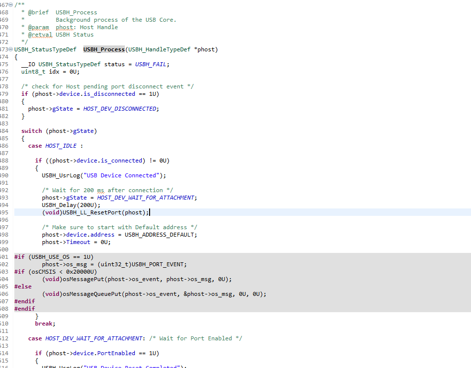

Hi.. I am working with stm32f429disco 1.. .I have generated with cube mx the fw init for usb host..
When I start my fw with the usb stick connected at least I am able to go inside the routine
USBH_Process
but when i run again the fw i am not able to stop in the same place..
What i mean is that with the usb stick connected just one time this variable is at value 1
phost->device.is_connected
The second time i try to stop the before variable is 0
Instead when I run the fw without the usb key conncted i never stop in the state
HOST_DEV_WAIT_FOR_ATTACHMENT
what could be wrong ?
It seems it is able to see the usb key just once and then something bad is happening
I think the setup from cube mx should be correct but i uploaded here ..
Can you please help me ?
VBus is enabled because the related led it is working..
Thanks

USB protocol requires real time response from the device. Stopping on breakpoint likely disturbs the connection and it fails. Find a way to debug without breakpoints.
