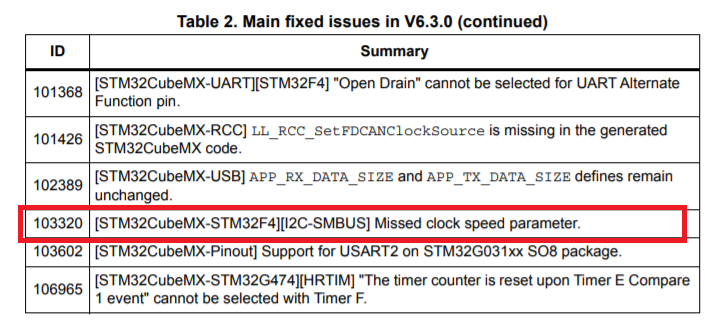

Hi @Community member​ ,
That is strange as the issue you are reporting is a known one and in STM32CubeMX release note, we confirm that it was fixed with STM32CubeMX 6.3.0:
0693W00000D0mENQAZ.pngI'll try to check this again on my side. Please make sure that STM32CubeIDE is embedding STM32CubeMX 6.3.0.
-Amel

Hi @Amel NASRI​,
Thank you for such a quick response!
I had to migrate the project to the newer version, missed the prompt that asked me to.
I see the problem is resolved.
