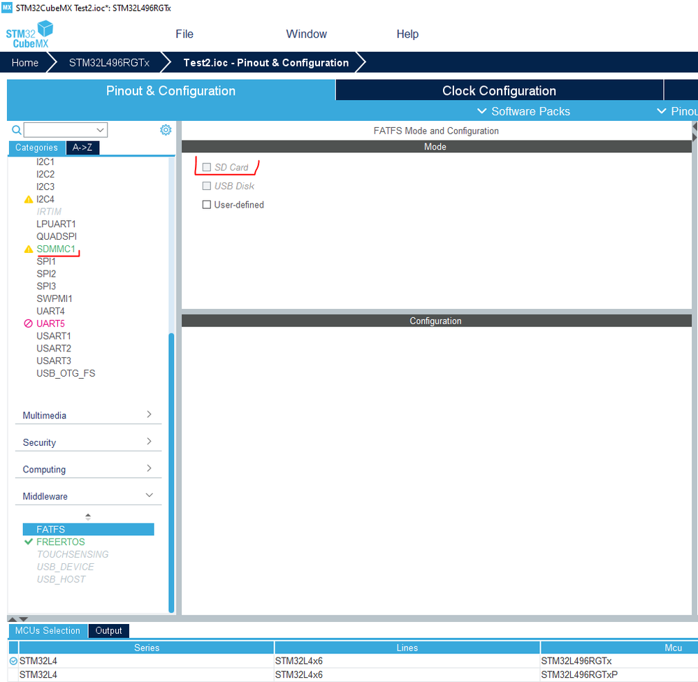

I have custom HW with STM32L496RGTx. On board I have MicroSD card slot.

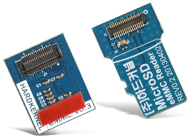

I would like trying emmc from Hardkernel with microSD reader like this:
I use CubeMX 6.1.1 with STM32L4 v1.16.0 package. If I set sdmmc1 to MMC 1bit in FATFS doesn`t offer SD card.
Why?
How to set up emmc+fatfs+freertos with STM32L496?
Please help
Thank you

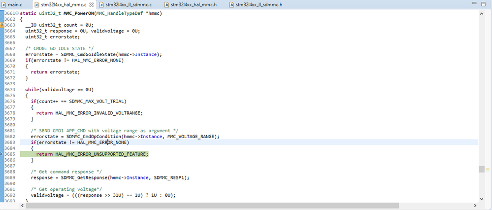

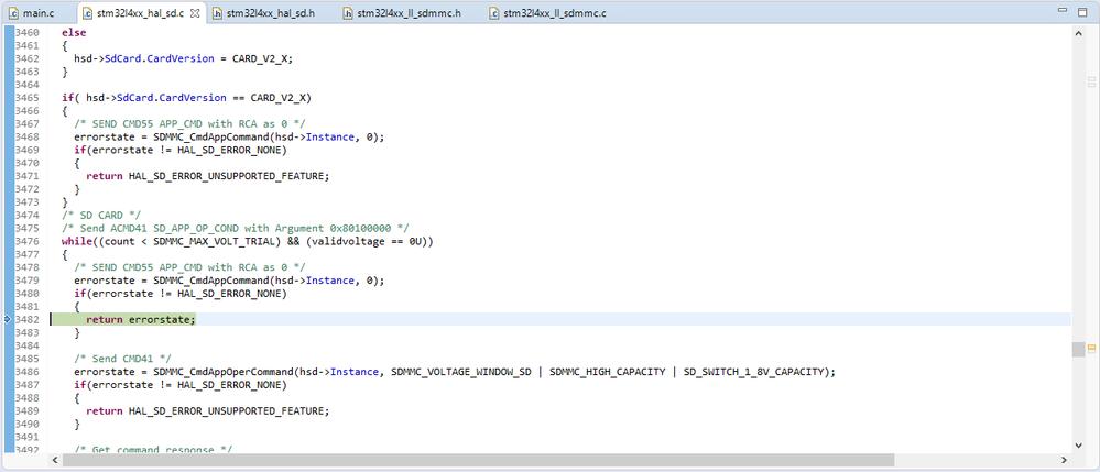

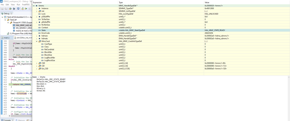

Tried set up only SDMMC. If set up SD 1bit or MMC 1 bit it is doesn't work.
In state figure MMC_STATE_READY
If I set MMC 1bit
I got error in:
SDMMC_ERROR_CMD_RSP_TIMEOUT for CMD1
If I set SD 1bit
I got error in:
SDMMC_ERROR_CMD_RSP_TIMEOUT for CMD55
please help
