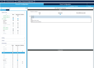

Dear Team,
When I am starting a new project in cube MX with STM32H7R7L8H6, there are options of I2C1 and I3C1. but I am not able to select and make it work. drop-down menu is not enabled!
I am using V 6.12.0
Does anyone have any explanation for this?
Regards
Umang
Solved! Go to Solution.
2024-07-12 2:26 AM - edited 2024-07-12 2:28 AM
Hello @Uman-Butani
You just have to enable the flash on the same context that you are looking to select for the I2C or the I2S (Boot or Application):
Best Regards.
