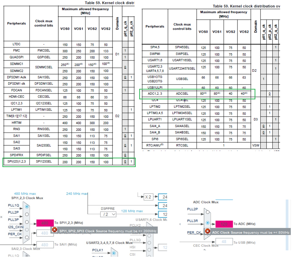

As for the clock settings - it appears that this version of Cube is creating/enforcing certain rules about clock frequencies that were not enforced in previous versions. For example: if the Power Regulator Voltage Scale is set to Scale 1, the Clock Configuration tab requires that the output of DIVP1 be <= 400MHz; in the past this was (apparently?) not enforced because in the previous configuration that output was 480MHz. There were a handful of these violations in the clock configuration when I opened it with the newest Cube. Looking through release notes for both Cube and the H7 code, I don't see any indication that the clock configuration rules changed, but I might have missed those.

In fact, with previous versions of CubeMX (6.1.0 / 5.6.1) there wasn't any clock constraint which wasn't correct. Backing to STM32H742, STM32H743/753 and STM32H750 Reference Manual > Table 59. Kernel clock distribution overview, each IP has its maximum allowed clock frequency depending on the Power Regulator Voltage scale value:
0693W00000FD9ZzQAL.pngI assume that this misbehavior is due to the ADC clock frequency (120MHz) and SPI clock frequency (480 MHz) exceeding the maximum value stated in the Reference Manual. Thus, the implementation of the clock constraint in the latest CubeMX version may have impact on the loading of some IPs.
