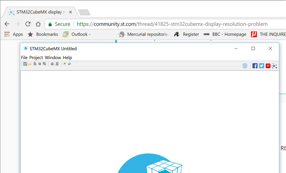

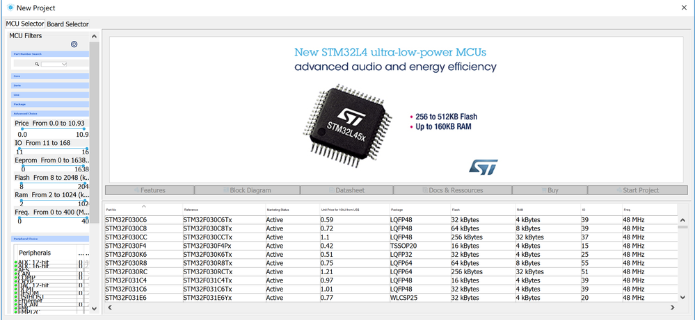

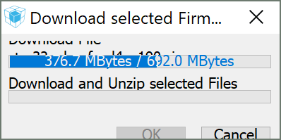

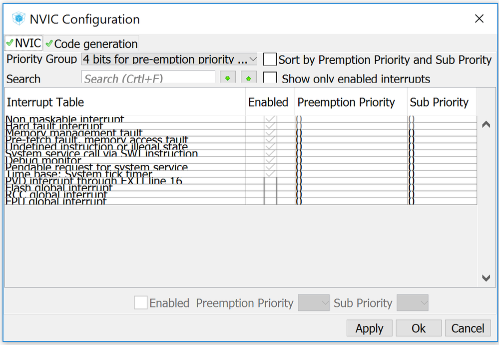

Hello ST team,
I think the STM32CubeMX code generator has a big problem with screen resolution. I'm using a laptop with 4K display, so my CubeMX appears like following screenshots, which are annoying in many cases: Almost half of most table rows appear vertically, the texts sometimes are too small or too large and so on:
Can this problem fix?

Hello CubeMX developers
I am sorry to be back with this issue, but 4K screens and CubeMX do not go together. We are here more than two dozen people facing this issue almost daily. No way to project educational slides with this kind of nonstandard dialog windows:
or speedbuttons that are as tiny as 2x2mm on some screens and not decipherable.
To ST HMI developers: Please keep in mind, that the first front-end impression to critical students may make it difficult for the instructor to pass a positive message about CubeMX to students.
Thank you very much for a soon release after 4.22.1 of software where listbox line height calculation and list item font size is being computed by the underlying native environment API and not apparently by the development tool which fails in this respect.
