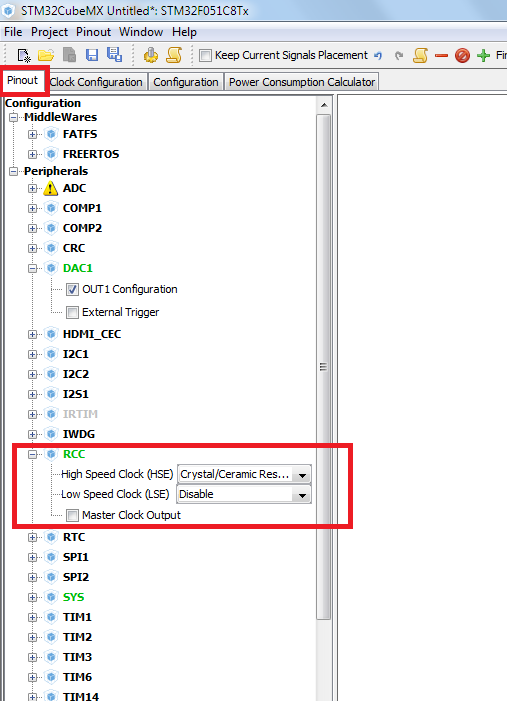

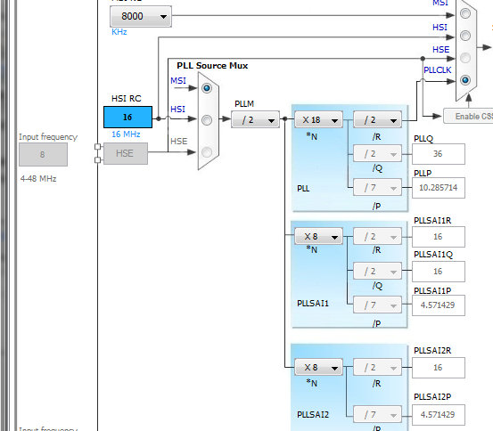

I am trying to configure external clock(HSE) for STM32L476 uC using STM32CubeMX,
Problem is that its disable in GUI , any way to enable this ?
Same goes for LSE
#stm32l4 #cube #cubemx #stm32cubemx

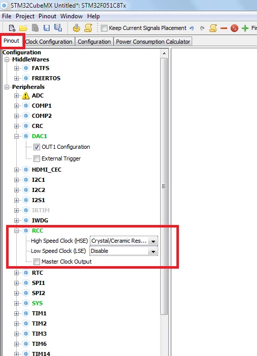

You need to select external crystal option from RCC in the previous tab. Then it will work.
avinash_elec
July 25, 2016
Posted on July 25, 2016 at 14:24
Goto pinout tab, then in the left hand list of peripherals find RCC. Inside it HSE=Crystal/Ceramic Resonator
Now you can see HSE enabled in Clock Configuration Tab
