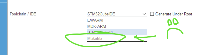

I just grabbed CubeMX 6.8 and installed it and created a new H5 project to test but I found that 'Makefile' toolchain/ide is not available, see attached. Any idea how to enable this?
When will the SVD files be published on the ST website as I cannot find them there yet?

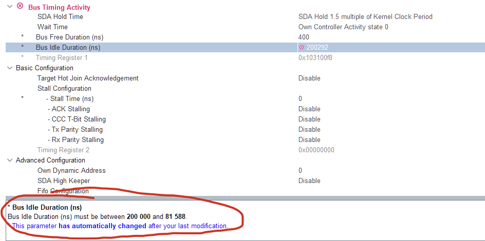

I'm also having issues with the UI when enabling the I3C peripheral, it complains about the Bus Idle Duration but the range is invalid, see attached.
Pavel A.
What is wrong? 200292 is not between 200000 and 81588.
DClif.1
two things:
1) the low number should be first.
2) if you enter a number within the range it rejects it, if you enter a number higher or lower than the range it rejects it too.
