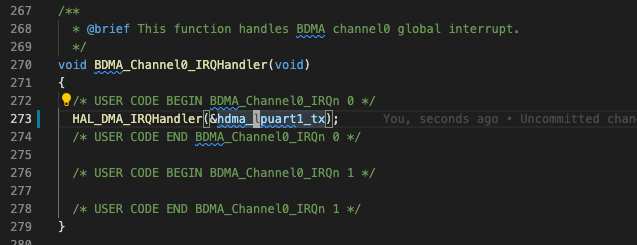

On the project we are using LPUART1, more out of pinout convenience than low power, but STM32cubeMX 6.30 and STMCube_FW_H7 V1.9.0 miss placing the HAL_DMA handler for LPUART1 in the BDMA handler.
Is there a better place to report STM32CubeMX and FW/HAL bugs?
Below is my simple fix.

Hello @Thomas E.​ ,
Thanks for this post and for your contribution in the Community :) it is much appreciated!
This is known issue with CubeMx v6.3.0 and this will be fixed in the next release of the CubeMx.
(Ticket ID 111521 : this is an internal tracking number and is not accessible or usable by customers).
Please allow me to close this thread and thank you again for having reported the point.
