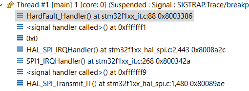

I have program for stm32f103 mcu. Now I want to do my SPI transmit routine using interrupt.
Before:
HAL_StatusTypeDef status = HAL_SPI_Transmit(&afe_spi, (uint8_t*) pData, 4,100);
Now I tried this (and many variants also):
HAL_StatusTypeDef status = HAL_SPI_Transmit_IT(&afe_spi, (uint8_t *) pData, 4);
	while (status != HAL_OK){
But data isn't sended. And in debug mode i can see:

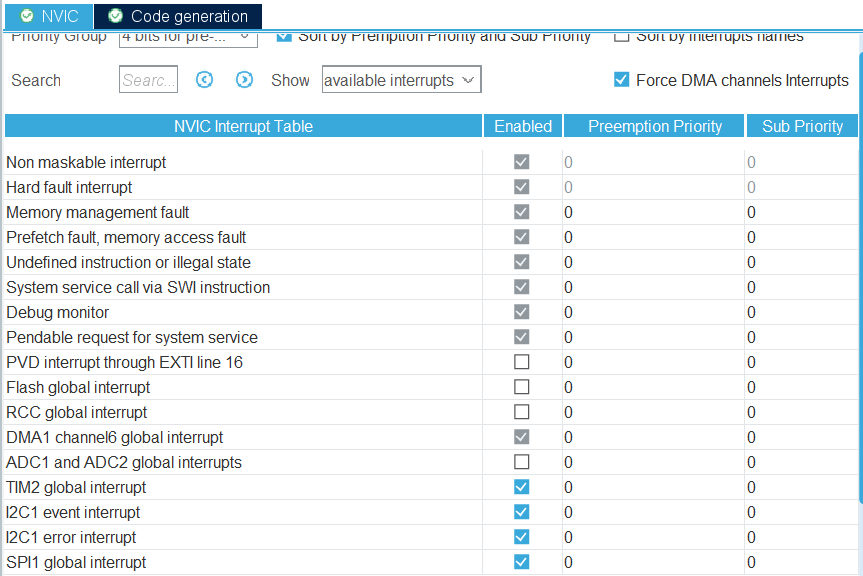

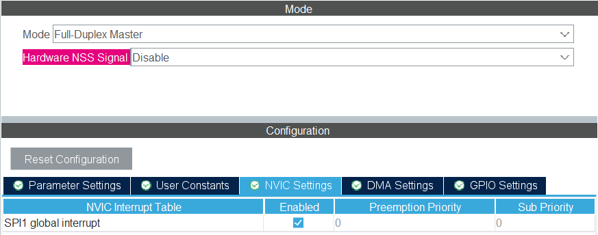

0693W00000aJKXCQA4.pngMy project settings:
0693W00000aJKXWQA4.png0693W00000aJKXqQAO.pngOther interrupt also not works.

Hi @EBurk.1​ ,
looks like you didn't implement the callbacks correctly. The IRQ handler will use callback functions to notify your software about events, like for example buffer empty or buffer full. You need to implement these. Look at some examples from the intro pack repository to get inspiration.

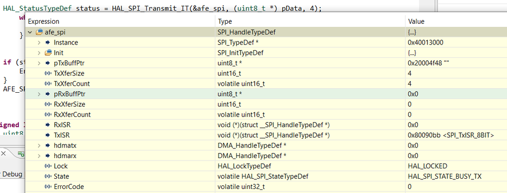

waclawek.jan
March 20, 2023
Where and how is afe_spi defined?
EBurk.1
EBurk.1Author
March 20, 2023
afe_spi is hspi1 SPI_HandleTypeDef
main.c:
AFE_INIT(hspi1);
and my afe.c:
void AFE_INIT(SPI_HandleTypeDef hspi) {
	afe_spi = hspi;
Without interrupt Tx and Rx working, but i can't get how to implement callback function. I need just to send data with interrupt without any special things for a start
waclawek.jan
March 20, 2023
OK so how is hspi1 defined?
In debugger, look at where it is placed in memory, and what it its content, and show.
EBurk.1
EBurk.1Author
March 20, 2023
// HAL_StatusTypeDef status = HAL_SPI_Transmit(&afe_spi, (uint8_t *) pData, 4, 100); // works fine
EBurk.1
EBurk.1AuthorBest answer
March 20, 2023
I changed &afe_spi to &hspi1 and it works! I forget about pointer =0
Thanks to everybody
