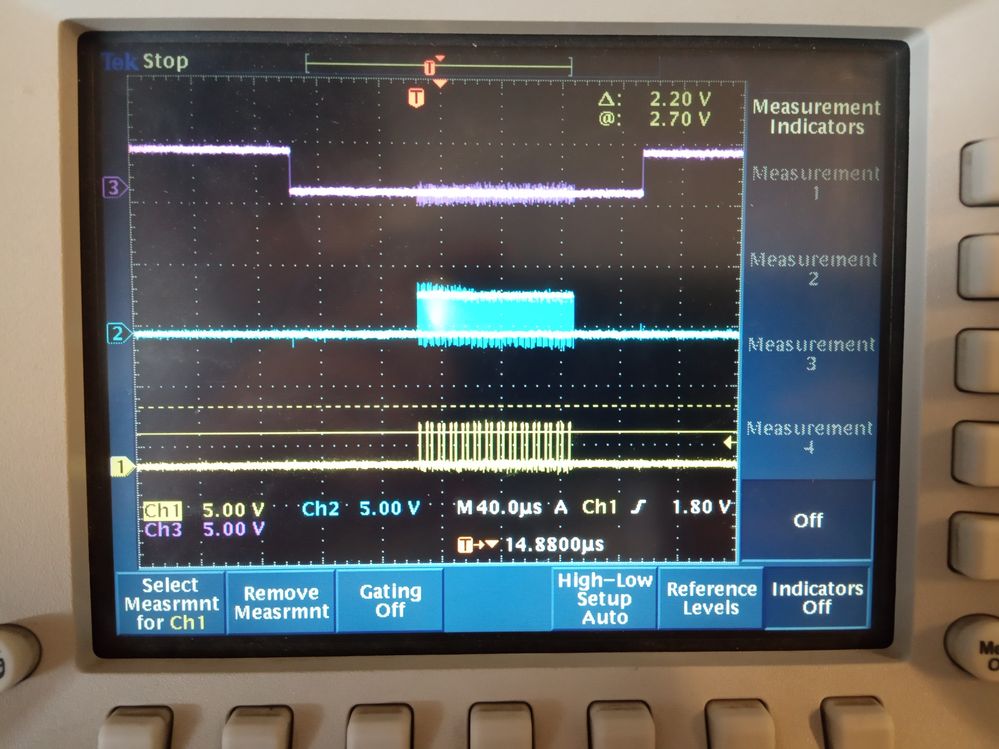

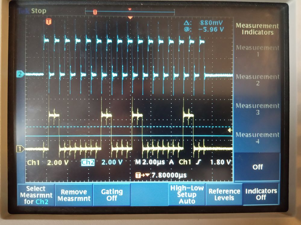

Here are some pictures of me sending data to the stm from the esp.
The probe's are pretty crappy and I'm probing with long cables, so please ignore the signal integrity issues, there not seen when measuring correctly.
CS line, mosi and Sclk:
 The Sclk and MOSI line when I send 'BB'
I'm not sure what's causing this, but I have a feeling it's an incorrect configuration somewhere. Any help will really really be appreciated.

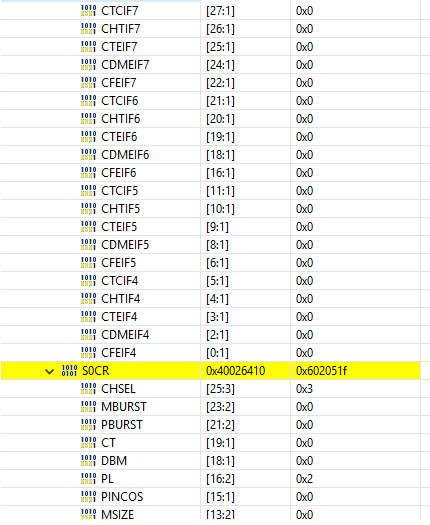

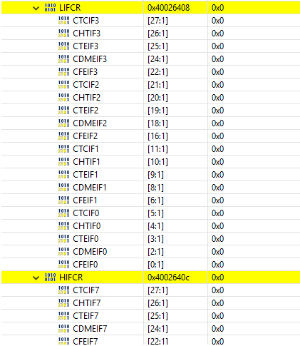

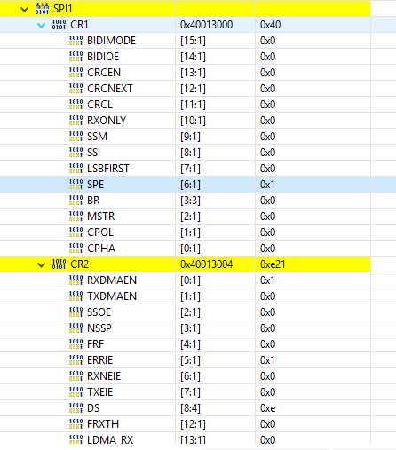

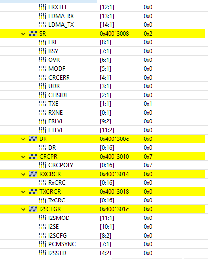

I can't see anything odd concerning the registers. Here's the register values:
After setup and prior to sending any data:
The SPI registers
The DMA registers:

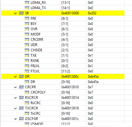

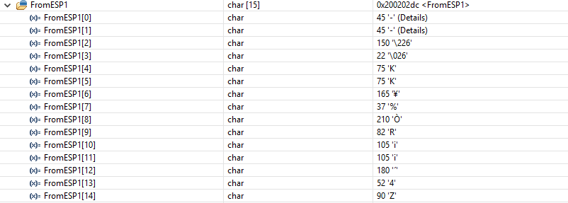

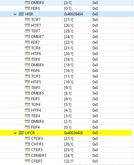

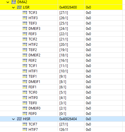

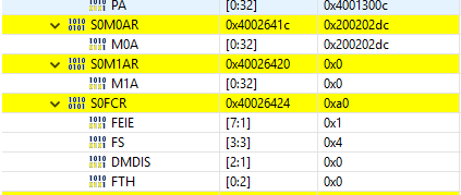

Here I send 15 characters all the same value which is 'Z' and this is the received data (Prior to sending, the buffer was filled with 0):
And these are the registers that changed after the data was received:
I'm still not sure why this is happening..
