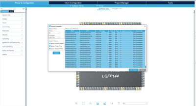

Hi, all,
I am trying to port my preconfigured H743 Nucleo board pinout setting to H753ZI Nucleo board, which is pin to pin compatible. I clicked the "list compatible MCU" under the pinout tab, but for some reason, the window just stuck in the loading process forever. Please see the picture below:
The progress stuck at exactly 70%, I can see the MCU I want, but I couldn't click on it because the loading is not done. Any idea on how I can fix this? Thanks for any suggestion in advance.

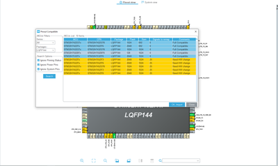

same behaviour for me. At 70% it doesn't go ahead also restarting PC.
I'm using STM32CubeIDE
Version: 1.14.1
Build: 20064_20240111_1413 (UTC)
Actual microprocessor is STM32H563ZIT6.
Hello @Maxer

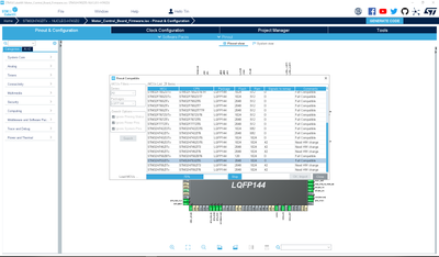

I've tested For the STM32H743ZITx:
and for the STM32H563ZIT6:
And it works fine. Please update your CubeMX to the last versions (V 6.11.0).
