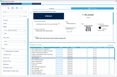

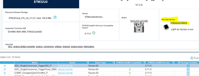

The MCU of NUCLEO-U031R8 is LQFP64. But if I import the example of NUCLEO-U031R8, STM32CubeMX shows it as UFBGA64.

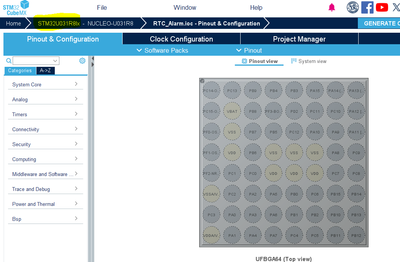

Hello @Torris-Yin ,
The STM32U031R8T6 MCU is an LQFP64 package, and STM32U031R8I6 is an UFBGA64 package.
In your case, you are using the example with STM32U031R8Ix which is an UFBGA64 package.

Hello, @Imen.D
I am using the example of NUCLEO-U031R8, which is STM32U031R8T6. I attached a video of my operation.
Thanks.

Hi @Torris-Yin ,
I see the contradiction now.
For the selected project: the mounted device is STM32U031R8Tx (LQFP64 package).
But, when you open the project, it is mentioned STM32U031R8Ix (which is UFBGA64 package).
Thank you for rising this up.
I escalated this issue to our CubeMX team (via internal ticket number: 198841)

Hello @Torris-Yin ,
This issue is fixed in the STM32CubeMX v6.15.0
