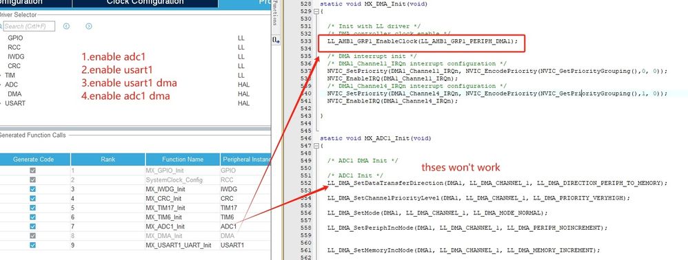

Old issues cubemx adc dma order
‎2024-11-21 4:42 PM
‎2024-11-27 4:38 PM

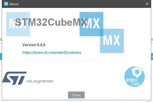

SSorry,I thought my Cubemx was the latest version
‎2024-11-21 4:53 PM
if i'm wrong , cubemx should give hint like this
‎2024-11-21 4:54 PM
it takes me a few hours to solve

Hello @lyiku.1,
1- The MX_DMA_Init order issue is already fixed since CubeMX V6.6.0:
Solved: MX_DMA_Init order in the main.c file generated by ... - STMicroelectronics Community
You are using an old CubeMX version, and it will be better updating the last one v6.13.0 through this link, as it contains enhancement and bug fixes.
2- The warnings are generated by CubeMX as a precaution, and you can ignore them as long as the tool allows you to configure your project with features that you need.
Thanks
Imen
‎2024-11-27 4:38 PM
