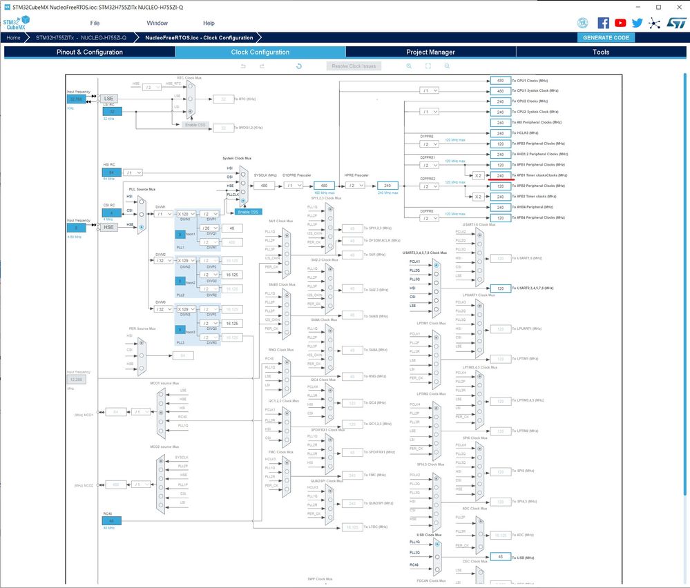

I'm using the nucleo-h755xi for testing purposes and I'm doing configuration by using CubeMX.
I have opted to using the FreeRTOS middleware for both cores, CM7 will be using TIM6 and CM4 will be using TIM7 to generate ticks for the OS.
Now my question is, looking at the generated code and my settings over at CubeMX. The configuration looks as follows (I've underlined one result with red for future reference):

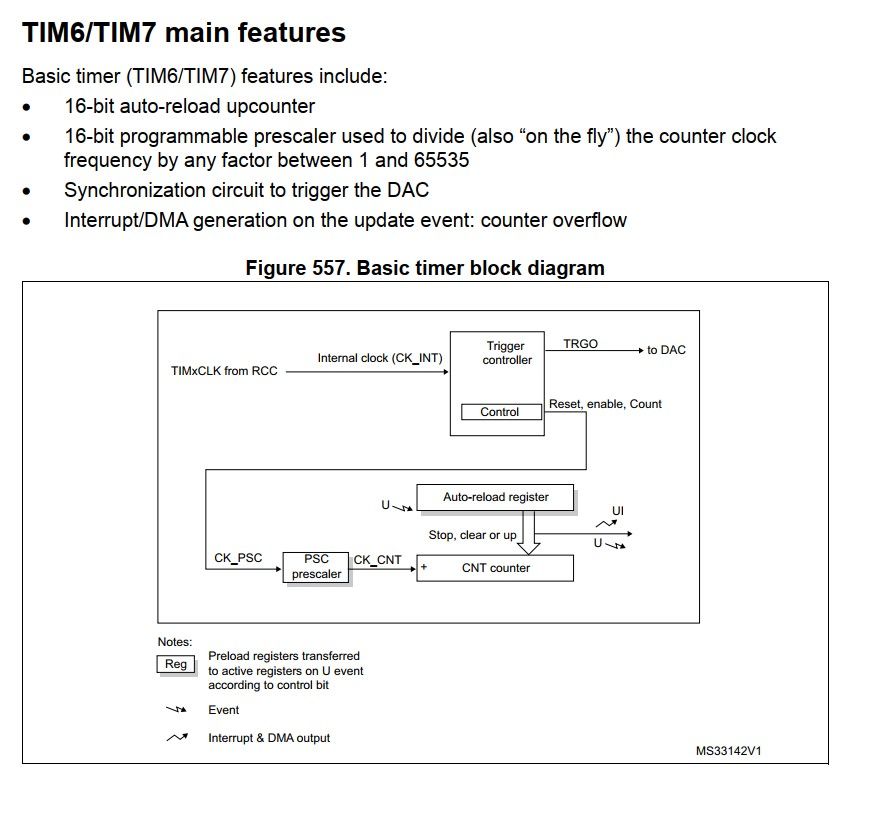

Now, in the reference manual it says:
This is how the Timer6 is supposed to look like.

First question:
Where does that 64 MHz come from? It is not in my configuration and I don't see dividers being able to accomplish this if you look at the CubeMX configuration.

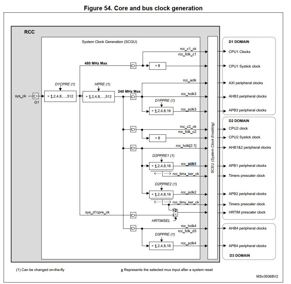

Above is a screenshot (again) from the reference manual. And showing the default values which do not scale the sys_ck at all to get close to 64MHz.
Is this scaling to 64MHz done during HAL_init -function call? It seems to have some macros in it.
My second question is: What are the clock frequencies in CubeMX used for (for example the one I underlined)? As I though these would be used for the timer frequency.
What is the frequency of timers 16 and 17 in this instance (since I can't trust my own reasoning apparently)?

2020-03-17 8:13 PM
I agree, it can be a bit complicated. Your understanding is correct--you shouldn't be seeing 64MHz based on your clock settings shown.
Is your clock set up prior to calling HAL_InitTick? Sometimes this is called prior to setting up the clock, and again after it is set up. Obviously the clock is different between the two cases.
Post your SystemClock_Config function, which configures the clock.
The timer clock frequencies should be as you expected--240MHz in this case. But only after the clock is set.
Is it possible you didn't hit "Generate Code" after you changed the clock settings?

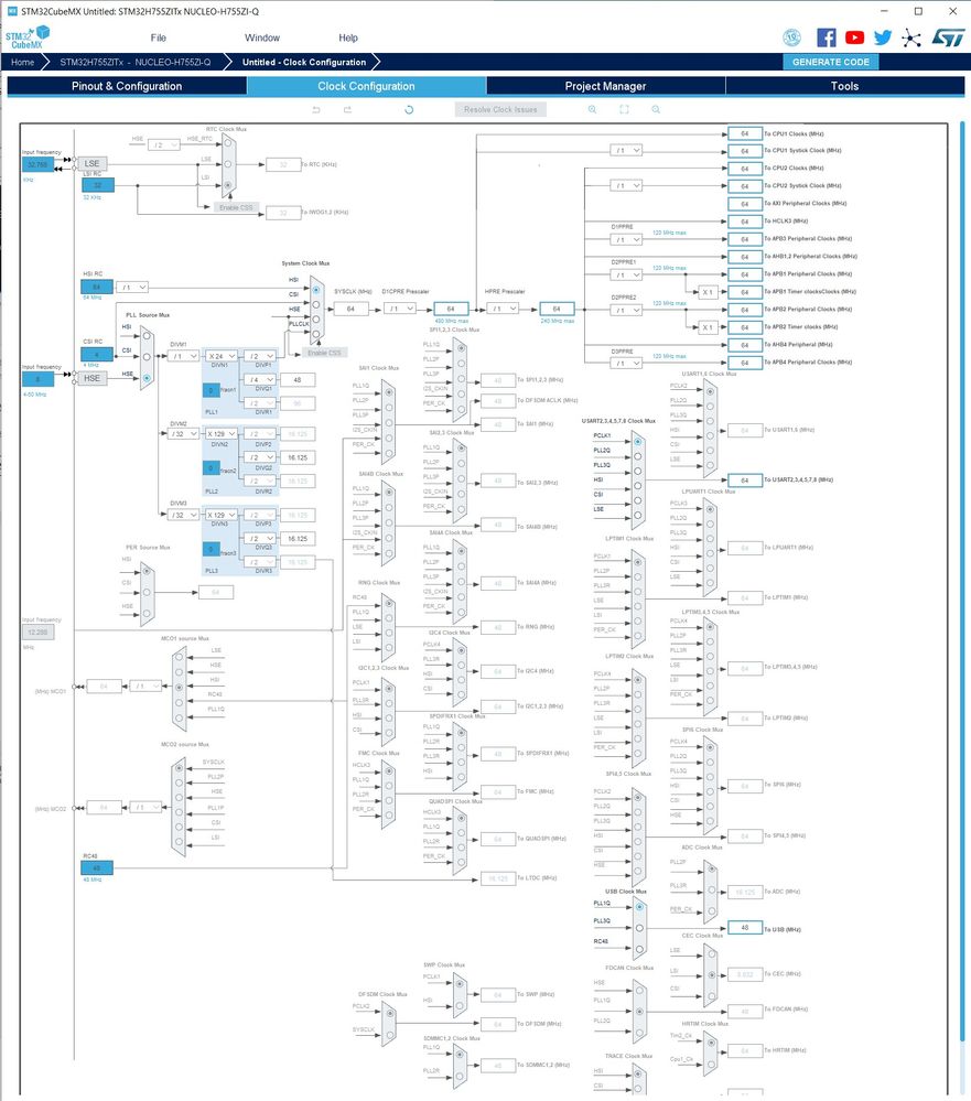

Maybe the code generation is fixed (so the examples work properly on it), since below is the picture for a nucleo project without changes (to peripherals or clock configuration.
Here, 64MHz or the HSI RC, is selected as the bus frequency.
This is also the default configuration for just the chip based project as well.

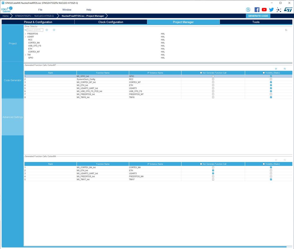

Now, this is the picture from under project manager:
Shouldn't the SystemClock_Config be higher? Like the highest one? Or you could argue that GPIO settings should be done first (to get access to HSE and LSE?), then SystemClock_Config, and finally setting up HAL_Init with ticks and the like.
