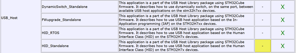

Have you seen this?
https://community.st.com/s/question/0D50X00009cd6whSAA/usb-hid-host-connect?
From the following document:
STM32CubeH7 Firmware Examples for STM32H7xx Series
The USB HOST HID IP is supported on the STM32H743I-EVAL but not on the NUCLEO-H743ZI so there is some minor difference to prevent the use of the same code run on the NUCLEO target.
