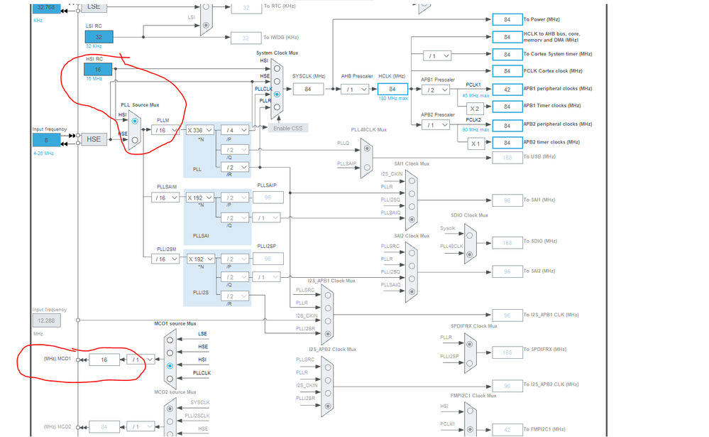

I have used CubeMx to generate a project which should do the following:
  • configure PA8 as MCO1 and on it I want to output HSI clock which as I understand is by default 16Mhz
  • So in CubeMx I configured PA8 as MCO1.

As far as I understand from CubeMx clock settings and also from the generated function the MCU is configured by default to use the internal oscillator(HSI) configured at 16Mhz.
In the generated code in the 'MX_GPIO_Init' I see that PA8 was properly configured to alternate functionality GPIO_AF0_MCO.
Also the function SystemClock_Config seems to have properly intialized the HSI clock and also in the last line from this function I see this was generated as well:
 HAL_RCC_MCOConfig(RCC_MCO1, RCC_MCO1SOURCE_HSI, RCC_MCODIV_1);
which configures MCO1(PA8 pin) to output HSI clock on it.
I'm using a NUCLEO STM446RE discovery board. From the 'board getting started' pdf file I have found that PA8 pin is connected on the arduino connector 9(D7).
So the way I have tried to sample the pin with an oscilloscope is this:
  • the probe on the D7 pin(PA8 pin of the MCU) of the discovery board
  • the probe's GND on some GND connection on the board
Is this not the proper way to probe a pin for a signal with an oscilloscope?
I have also debugged the code and there is no error handler beiing thrown.
But when I look at the oscilloscope the output from the pin is just a steady logic one with no frequency at all.
What am I missing?
Here is also a picture of the clock settings from CubeMx maybe I missed something there.
Thank you for reading!

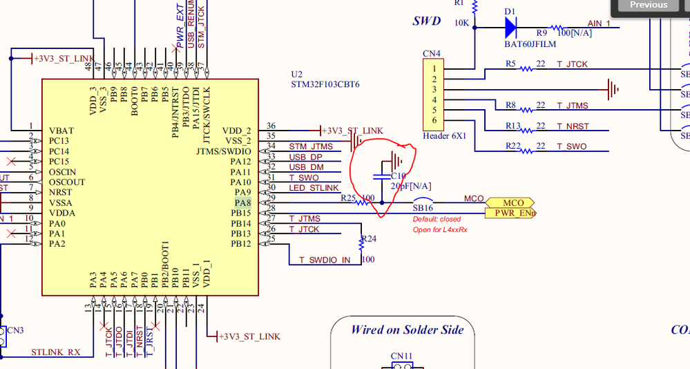

Also I have noticed something in the board schematic(page 65/69 of the nucleo board getting started page - i posted a picture below).
Apparently there is a 20pF capacitor attached to the output of the PA8 pin. My electronic skills basically do not exist but could it be that that capacitor there acts like a high pass filter so signals with a high frequency(mine is 16Mhz not sure how high is that considered to be) are filtered so they take the path with the capacitor instead of going out of the pin like I was expected? And if I'm right about this what is the reason for that capacitor there to let you output only low frequency of the clock?
Or maybe it's a joke from people who designed this? HAHAHA :D
waclawek.jan
That's the onboard STLink's schematics ('F103), not the target mcu.
