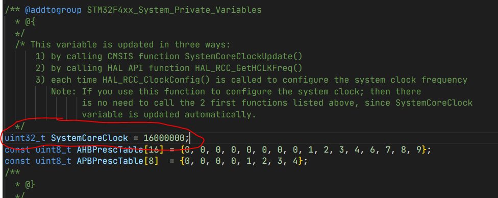

Newcomer questions~Why the "SystemCoreClock" is 16000000Hz ?
  • September 14, 2022
  • 1 reply
  • 1358 views
I used Cubemx to configured the system clock to 180MHz. Why is the system clock in the generated project code...... 6 zeros...... 16MHz:grinning_face_with_sweat:? Can I change 16MHz to 180MHz?It simply changes the number after "SystemCoreClock" to 180000000?
Best answer by Tesla DeLorean
MCU starts from an internal clock, when you get the external clocks and PLL running the value will be adjusted.​
1 reply
Tesla DeLorean
Tesla DeLoreanBest answer
Guru
September 14, 2022
