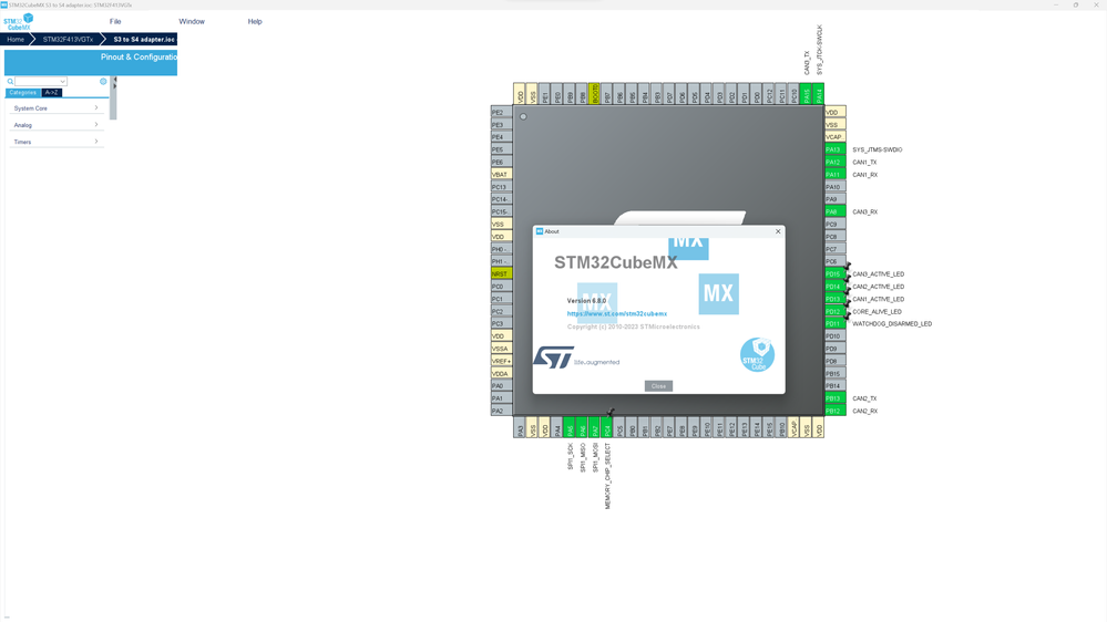

The issue I am having is that CubeMX (latest version from the website) is totally messed up in my desktop PC with windows 10. Everything works fine on my windows 7 laptop.
One picture tells more than a thousand words so here are two.
It's totally unusable. Never seen this kind of behavior with any software I am using in my windows 10 desktop.

Nawres GHARBI
Hi @EKokk​
Could you please tell me more about your setup
java version
Windows version (32 or 64 bit)
screen size
Resolution already shared in your previous message 1680x1050
Ram Size and how much RAM is free when you got this behavior

Same problem here, 4 years later, lmao.
I7 13700k, RTX 3080 Ti.
Windows 11 Pro, 22H2.
4K resolution, 150% scaling.
32gb ram, ~22gb ram free.
Latest stm32cubemx version.

Hello Kudos, I am using a laptop which uses RTX3060 and 2K display and I got same issue as yours.
I figured out a workaround is set the window -> display size to larger, and then UI glitch issue disappeared.

On windows set environment variable J2D_D3D to false can fix this.
You can use the PowerShell command to do this as
setx J2D_D3D false
It seems like unappropriated graphical acceleration issue on windows platform which provide by DirectX3D.
