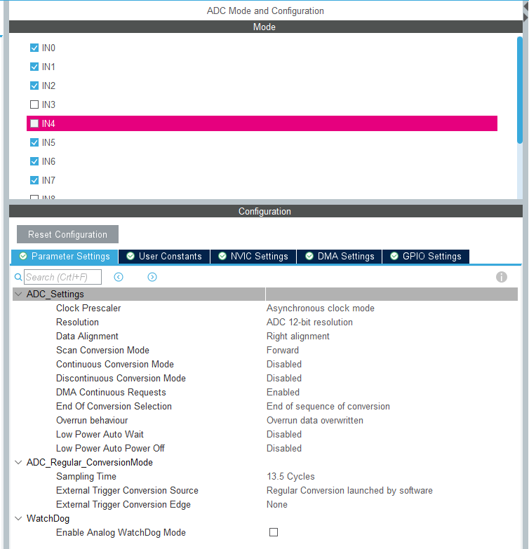

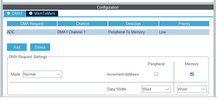

STM favors reading all channels at once instead of the adc reading method you are trying to use. Below is my multi-channel ADC application with STM32F0. I read 6 channels with a single line of code and use the value I need at that moment.0693W00000HohTYQAZ.png0693W00000HohTdQAJ.png
uint32_t ADC_Reads[6];
// ADC Read Code
HAL_ADC_Start_DMA(&hadc, ADC_Reads, 6);
//Instead of HAL_ADC_PollForConversion() I am using a variable whose value I change in the DMA transfer complete interrupt.
NJP.1
NJP.1Author
December 15, 2021
Thankyou for the reply , but in dma mode of conversion i heard that only the dma is executing all the time it seems not allowing our main function to perform that is the reasion i choose polling method and also my requirement is very less just to read a 4 adc channel and to process the things depending on the input values
MFran.4
Senior
December 16, 2021
No you can trigger a sequence of conversions that will stop until you retrigger it again. The example from Muhammad does exactly that.
You start the adc
you wait for conversion completed (see the comment on the fourth line above)
you read the value you want from ADC_Reads
